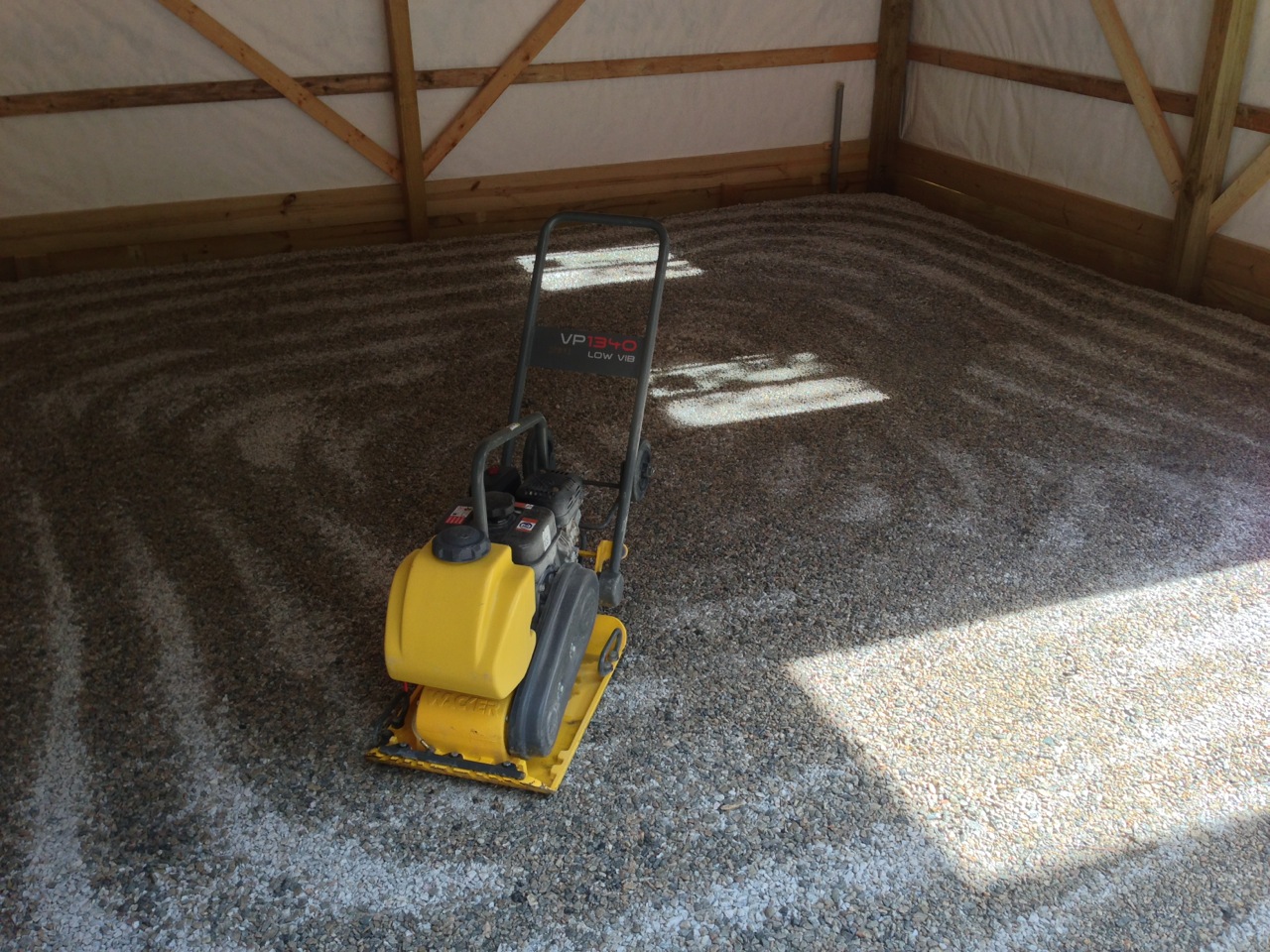

Compaction is key with a slab. No matter what else you do right, if you don't have a compact base, your slab will fail over time. Not to say things can't go wrong on top of a well compacted clean fill base, but as long as you pour 6" with fiber or WWF, a single or double #5 rebar at the edge you drive over, and pour a real 3000 psi concrete at a reasonable slump (6" slump is ok, but order a 5" and add no more than 10 gallons of water to a full truck; your good to go for 50 years.

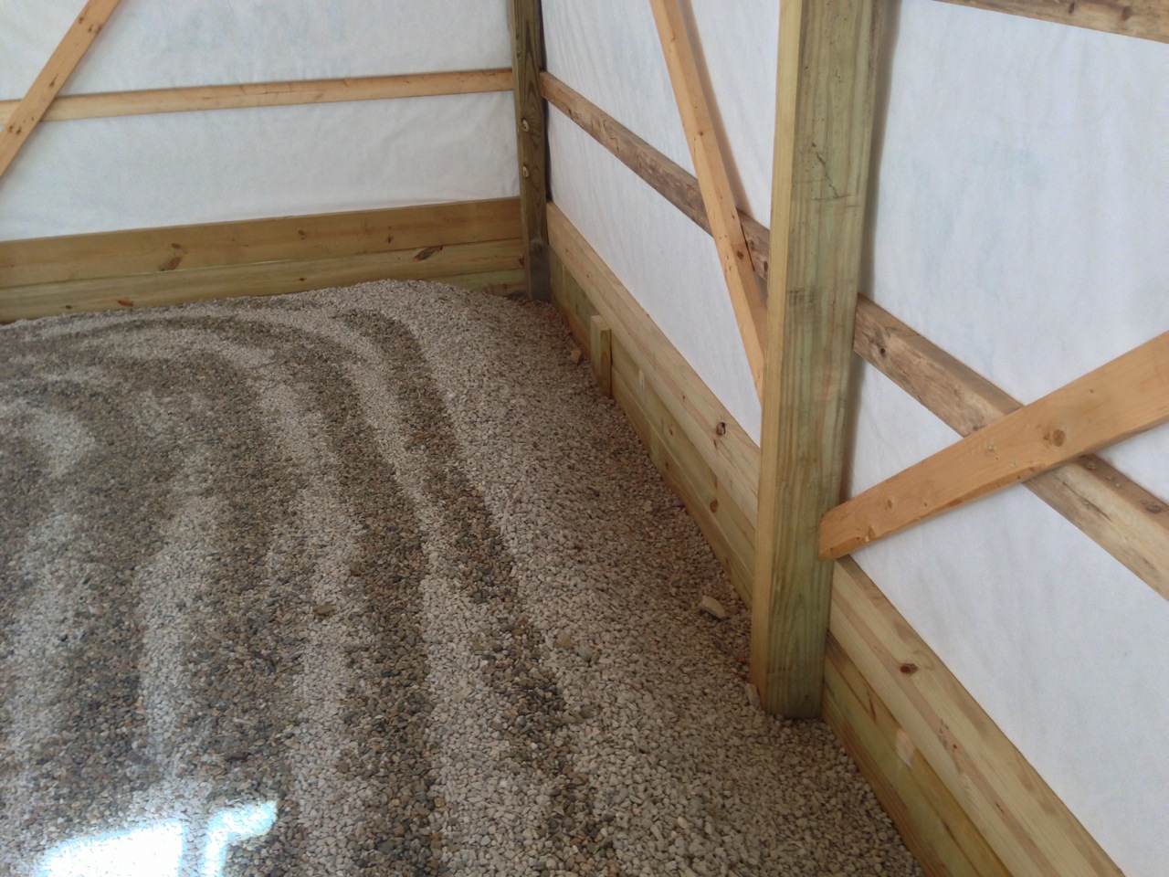

Have you already built the pole barn? If you haven't started yet, and you are going to pour concrete, then you are better of going with stick frame construction. The advantage of a pole barn is that you don't need to spend the money on concrete to have a strong building. But if you are going to spend the money on concrete, then that advantage is lost and you are better off stick framing on top of a concrete footing.
If you have already built the pole barn and now want to add concrete, there is no advantage to having footings around the edge since there isn't a load to support.

Did you build up original soil and how was it compacted? You will never get soil compacted with a vibratory compact. A jumping jack does alright for small areas, but you really need a vibratory roller to do it right. I worked jobs where we failed compaction tests after days of running compactors over it. Getting new soil solid is very difficult!!!!!

It will not be heated. If it's too cold for me to be outside, I'm staying in the house!
As far as the animals, I have spread 6 to 8 inches of crushed concrete out 12 feet in each direction around the barn. Will that not deter animals? My soil is called "sandy Loam"

I had a well known dirt guy in the area come out and make me a built up area before building the barn. I trust him to use the right type of dirt for what i'm doing. After the barn was built he came back and leveled the inside with what he refered to as "select fill" also called "cushion sand" around here.
