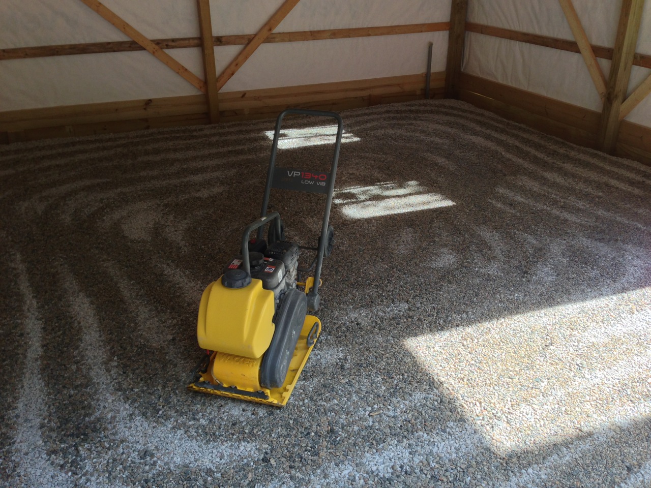

Here's a shot of the compacted gravel bed in my pole barn that will soon have a floor poured. You can see the turndown on the edges, which is mainly to contain the fill bed so that it does not settle outward and bow the skirt board and walls.

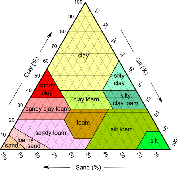

My soil is called "sandy Loam"
Sandy loam should not be considered expansive,
some depends on the ratio of the sand to loam ratio, but Clays are the real problem,
as one can see in the soil chart here, sand has no expansive chartists, clays the most and loams have some,
but sandy loams have over 50% sand in them.
I do not think one would have any trouble,
