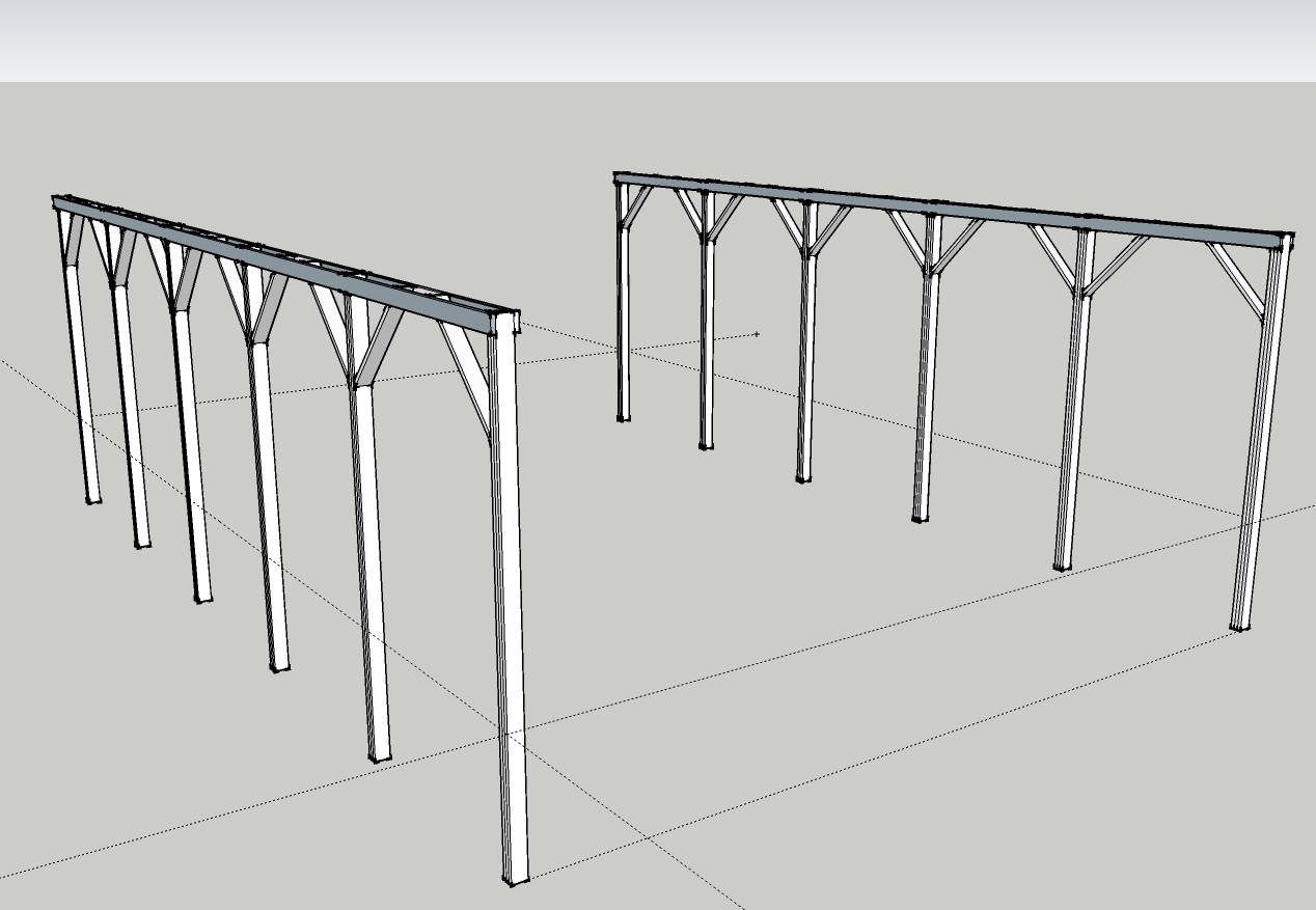

Latest progress:

What is the function / purpose of the knee braces? Seems like extra work.
If the trusses are located at the same spacing as the columns, only a girt is needed at the eave.
Just wondering.
Just wondering.
Yooper Dave
I was wondering the same. This over-design is missing out on the benifits of a pole building.....

   / Pole Barn Design-Over Building? #34
Lateral stability. And they look nice:D
Knee braces up that high provide very little lateral resistance. I doubt the columns can accept the axial load from the braces induced into their side creating a weak-axis moment.
Those brace(s) need to extend down to the kick-board - that will provide effective lateral stability.
Post and beam construction is somewhat similar - but the members are substantially larger, and able to resist the imposed moment.

   / Pole Barn Design-Over Building? #35
Yooper Dave
OK, Thanks...
I will let my builder and county inspection department know they are wrong and the braces are not needed.

OK, Thanks...
This is why is never posted a thread on building my building...to many opinions..Not say you are wrong.
The good thing here is you save $125/hour of structural engineering consulting fees in a relaxed format.
I will say I am concerned for the safety of the public. People expect a building to be safe - it is assumed.
Yooper Dave

   / Pole Barn Design-Over Building? #40
I agree they look nice.
I rarely look at who is posting; my fault. I thought it was the original poster with a revised design for his future building.
If looks count, then that's different. For a covered pole barn often the idea is to have a good building, and make it cheap but sturdy.
Assuming it is tinned as most pole barns are, your supports aren't visible from outside. So the pretty - which I agree - gets lost.
As to support, I'm sure they offer some, but seems like a lot of wood & cutting & working up high; when the same support could be added with a few metal straps or top to bottom 2x4 angle bracing. The proportion of your andgles appear to be more for looks, than for good support.
Nothing wrong with your design if you are paying the bills and you pay extra for 'looks good'. That's cool. :)
For those looking to build a sturdy but inexpensive storage building, there would be simpler (ie cheaper) ways to build that.
I have a machine shed that was dragged ontot he place I guess in the 1940's, and added onto 2x, with the roof lifted once. It is built out of 2x4 for a lot of the support, and _not_ on 24 inch centers. Sort of 1/2 pole building, 1/2 stick built. It would _never_ pass a building inspection. The interior poles are set on piers that are 6 inches or a foot deep. And so on.
Somehow it keeps taking the MN winters here. And it has some of those top supports in it. They help, but they are too small, too weak.... But it keeps standing.
So, I'm not meaninb to be critical of your building! I guess I was looking at different angle than you were, and sorry if I came off wrong.
