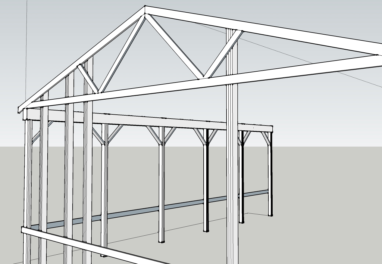

   / Pole Barn Design-Over Building? #28
There is a little engineering to building a good shed. Height of the walls is important, I didn't notice you ever mentioning that..... No one can really tell you what size poles to create without knowing how tall the sidewalls are - wind load gets worse on taller buildings.
Don't use green wood, or untreated wood, in the ground. That was aready covered, but reading this thread, I just had to say it also! 9 times out of 10, that would be a foolish mistake that would wreck your day within 10 years.
Often the best bang for the buck is to have a truss only on top of each set of poles. Then that top board around the walls doesn't have to be so big as it doesn't hold any weight. The trusses need to be bigger, but you only need 1/2 as many. Put the purlins on edge & possibly closer together - but it still pencils out cheaper this way than trying to do 6 foot poles & 3 foot trusses (or 8 & 4) - every other truss will want to sag, so you need a terrible strong doubled top girt.
If you engineer it all out proper, the best bang for the buck is a bigger truss, less of them, and perlins on edge to hold the tin.
If you just are guessing and overbuilding here & there and underbuilding there & here to hope it all holds together, well then who knows what is cheaper or too cheap?
I do hope the package deal comes out cheaper for you - it should. :) But the planning & figuring is sure fun, so no harm in that.

Latest progress:
