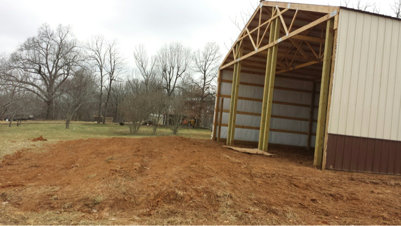

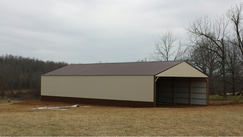

Finally got the building up , just have to pour the 30 x 40 part of the floor then I can finish. Still have dirt work to do but it's a bit soggy. :(

It's a good feeling when your equipment is weather protected... good job!
   / pole barn designing 40x64ish
#63
Nice barn. Still waiting on better ground conditions to get moving on mine.
