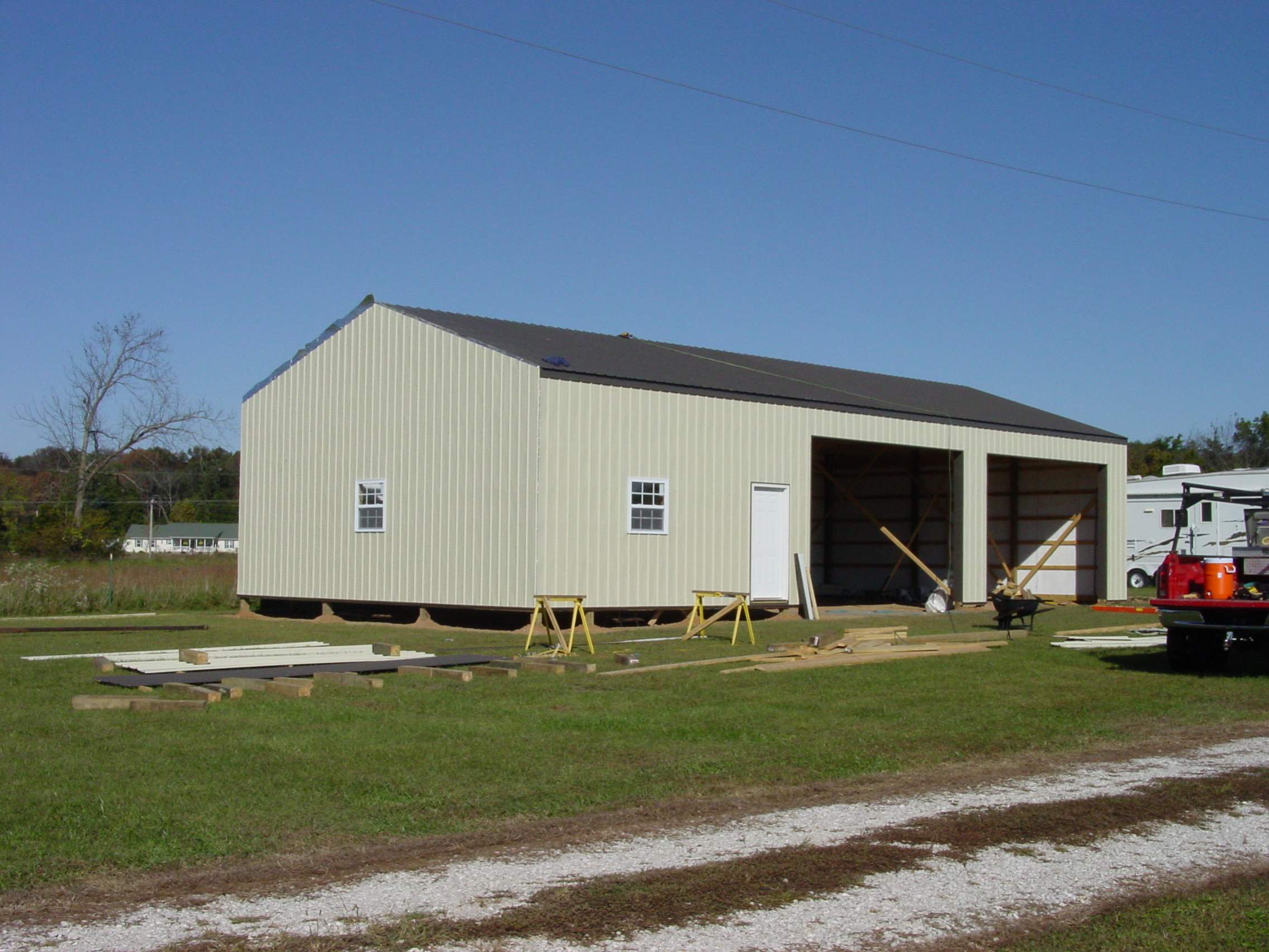

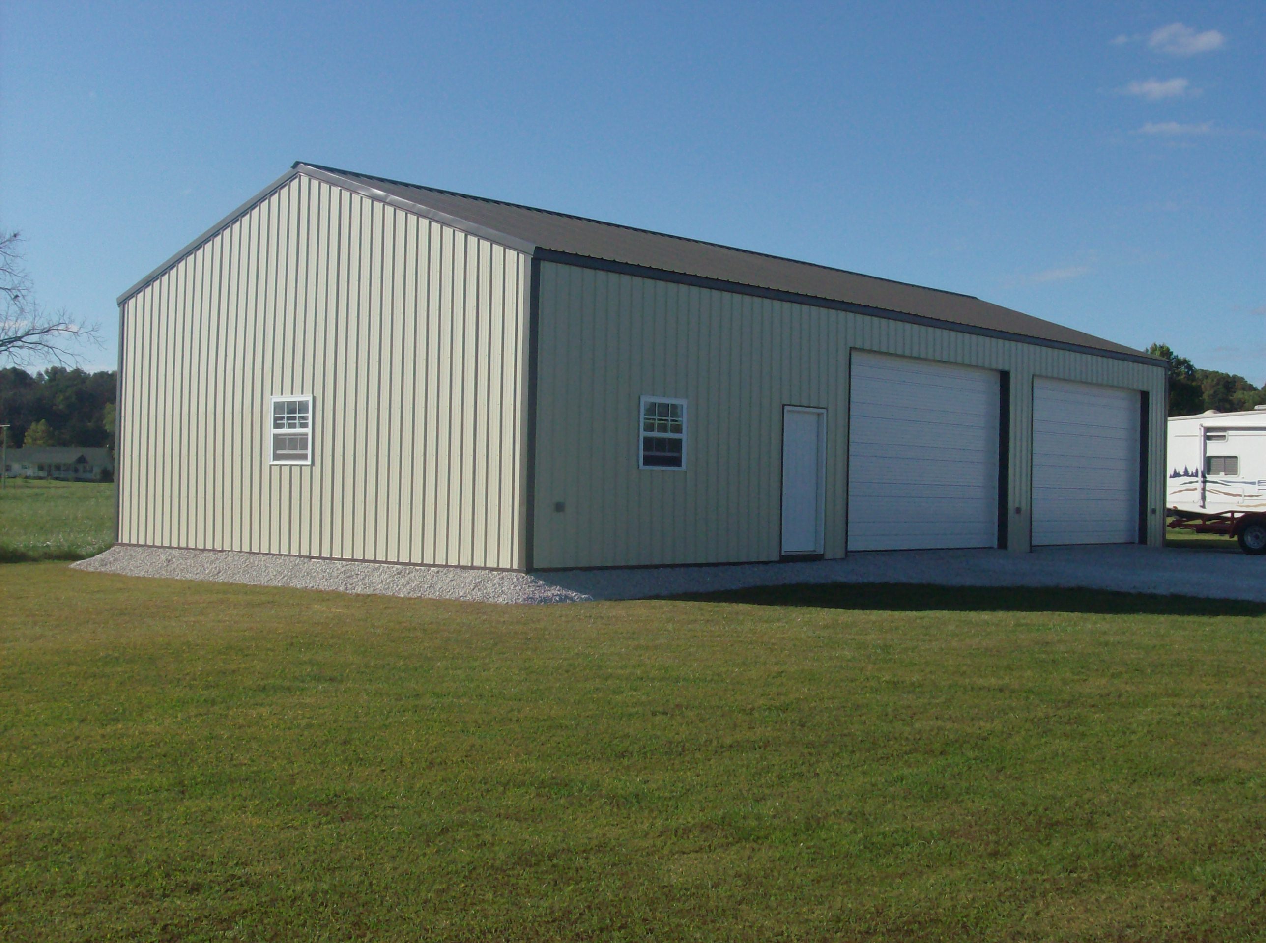

This situation is exactly what I faced when I built my 30X60 shop building. I had a guy level the building pad and we thought it was right on. However when construction began it was obvious there was a problem. The actual drop was from 0 to about 15" right to left. So, the builder installed pressure treated bottom headers in the appropriate places gravel was put into the interior area and leveled. Concrete was then poured to create a nice floor. Later that year, I created a gravel berm around the building to aid in water control and to give it a finished look. Its worked out well for me.

Mike, that looks very nice. This gives me some encouragement as I enter into the meat of my project in the next couple of days.
   / Pole Barn Floor Leveling #25
I hope my post gave you some ideas to work on. I would also tell you to put down gravel as a floor base as others here have stated. Dirt floors are incredibly dusty and hard on equipment, not to mention your lungs. With gravel you also have the added benefit of pouring concrete at a later date if so desired. Your project is looking great--Good luck! Mike.

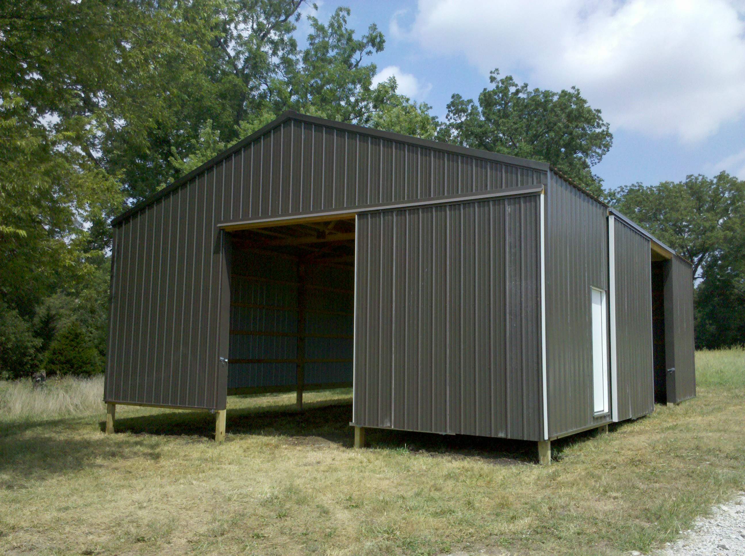

Here's a picture I took of my progress today. I'm pleased with the way it's turning out. I have about 3 hours or so left to complete the work.
The material seems to be working out well. If I have to adjust down the road, with insulation, different aggregate topper, etc., it shouldn't be a problem. I am using a vapor barrier to try to control moisture wicking from below. They are calling for rain tonight, so tomorrow I should be able to gauge how my drainage is looking.
