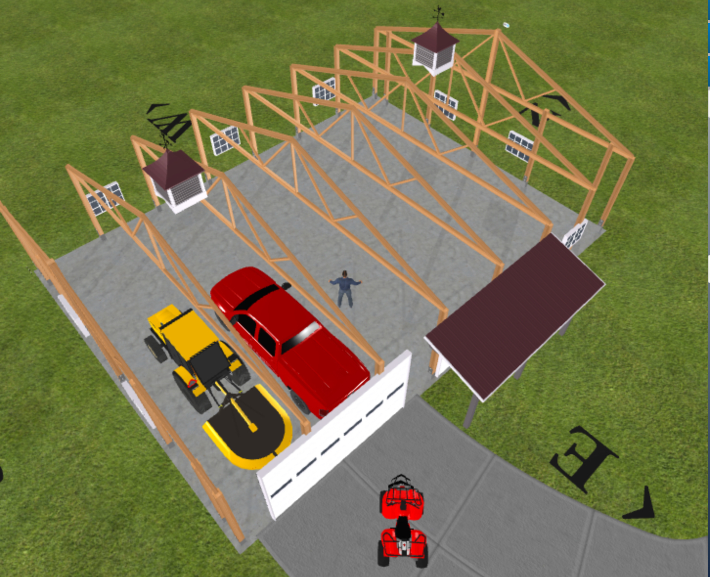

Looking for advice. The new 40x56x12 shop will be erected this summer. It will be used for equipment repair and woodworking for the apiary. I like lots of light when doing these tasks. I had thought about installing (2) 8’ LED lights per truss, at 12,000 lumens each. This would be 144,000 lumens total, 64/sqft
Ive read conflicting information on whether this would be enough.
Here is a layout of the barn. I figured (12) linear lights attached along the trusses would offer more consistent lighting. Thoughts?
I had initially looked at fewer, higher output UFO lights… but most of those are high bay, and 12’ doesn’t seem to fit as a high bay. Also, it seems fewer, higher output lights would create more shadows and dark corners.

Do you know the lumens? I’m trying to figure out if 64/sq foot is good? I’d like to be able to do surgery in there 😂

I have 80K lumens in a 28'x42' workshop, (68 lumens/sqft). Mine are hi-bay T5's installed 20 years ago. Today I'd go the LED route, that was not an affordable option 20 years ago. As I get older I realize you can never have too much light.

The only way for me to go higher, is really to install the UFO lights, which I’m afraid won’t distribute it as evenly. 🤷🏼‍♂️

You're using the wrong measurement for a scientific determination of your lighting needs. LUX is the measurement for light provided at the work surface. An office needs 500 LUX, and examination room needs 1000 LUX and an operating room needs 9300 LUX. Don't put in the 9300 LUX - you risk sun burns.
The lumens you are providing, which may be all you're getting from the seller, doesn't tell you want you need to know.
However, the unscientific answer to your query is - double the light tubes you're intending. LED light tubes can be directed. If each fixture has two tubes, you can direct one tube toward one bay, the other tube to the other bay. Also, plan for some drop cords, so you can bring light in under the car hood

I can only tell you what I have done. I have a clear span bldg 40 X 60 X 14. It's divided into 2 sections, 30 X 40. I had qty 6, 400 watt HPS lights/ GE Luminaire/ in the working area of 30 X 40. I replaced them with qty 6, Hykolity 250W UFO LED High Bay Light Fixture, 35000lm, 5000K. Basically in the same positions as the HPS but approx. 24" higher. I like the white light versus the yellow light. After several months of working in this new lighting, I think I need at least 2 more fixtures to make it equivalent to the HPS lighting. I have shadows and dark areas which I didn't have before. And that means adding some lights and readjusting some positions. I will probably add 4 more lights to make it even better than before when the finances allow. That's what I know.

I have around 60 lm/sq ft in my pole barn with 4 foot LEDs and it's pretty good for my old eyes. I don't have them evenly spaced. I have about double the average density over the work benches and less than the average on the far side that is just storage. I started out with fluorescent and slowly switched to LEDs. I tried the Menards cheap lights but found them to be unreliable and bought a couple of different brands from Amazon and they have been good.

Thanks! Yeah, I’m shooting for 65-80 lumens per sqft if possible. This would be using 2 or three 8’ lights on each truss.

Almost hate to bring this up, but it is relevant to your question. There's a thing called the inverse square law. Lighting spreads out over a larger area the greater the distance from source to subject, but the intensity of the light also diminishes. If you double the distance from the light source to the subject (2x), the intensity of the light diminishes 4x. Inverse Square Law for camera, with calculator for distance and intensity
The higher up you put your lights, the more area they will cover, but the intensity of the light will fall off inversely from the square of the source to subject distance.
So when you start with knowing the output of a given light, you then also have to figure the falloff based on the distance using the inverse square law.
Then you have the issue that you may have good overhead lighting, but a hood or something blocks your overhead lighting. The suggestion to also combine task lighting makes good sense to me.

It's true that the inverse square law will cause the intensity of the light from one light to fall off, but we're talking about a defined area with multiple lights. As the light falls off from one light it will be reinforced by an adjacent light. If you have fairly reflective walls and ceiling, the height doesn't really matter much. On the other hand, with dark walls and no ceiling, the height will make some difference, but not much unless the ceiling is 16 feet or more.

I have a barn 40x60x14 divided up into (3) 20x40 bays. Each bay has (2) 4' T8 fluorescent fixtures with (4) bulbs each at 3200 lumens per bulb at one end. So each bay has 25,600 lumens about 10' from the wall and will have another 25,600 at the other end shortly. I've not done the other end of the bays yet, but it will get the same treatment. I also have 2 fixtures in the middle of the barn sorta as a "night light" just to get around in it at night. Total lumens I can turn on is 102,400 and for the way I have the barn set up, it's enough to do pretty much anything I want to do, and puts me at 42 lumens/sqft so the other lights are a low priority. (I have them, but getting up to the ceiling to install them isn't so easy.) But, there is still a need for task lighting for some things. Once I get all the lights installed I'll have 179,200 putting it at 74 lumens per sqft.
Note: When you install lights in a garage, be sure that they are beside or between vehicles instead of over them so the light actually lights the area instead of casting shadows. In my 2 car garage, I have 3 lights. Then task lighting for working "under the hood".
