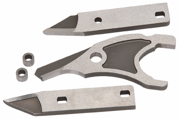

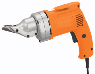

The professional crew that built my barns has been doing it for 35 years. They use this tool, a metal shear that costs $39 at Harbor Freight. They build about 75 barns a year. They told me they get very good service with these tools.
Harbor Freight also sells a replacement blade and anvil set for it for $19.
I think this qualifies as a Harbor Freight tool that doesn't suck.
It has a swivel head to make cutting curves easier.

The HF shears shown do not work (for me at least) cross panel, they do not have enough bite to make the ribs. You need to bend the metal quite a bit to get them to go through. They are however EXCELLENT at going lengthwise on the panels, better than the air shears, they have a different head on them.

I also have the Malco Turbo shear, and I would look for the attachment that will attach it to the drill, not use two handles, actually I would by the HF three toed shear and use it.
