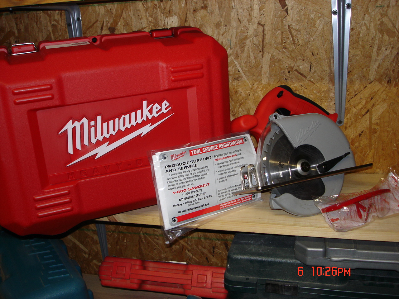

The Milwaukee metal cutting circular saw works great for cross cutting, diagnol cutting and ripping the panels. If you cut with the finished side down, it glides across the ribs (that become valleys when the sheet is placed finished side down) and it cuts about as fast as a regular circular saw cutting 1/4" plywood. It leaves a very smooth edge and makes far less noise than I expected. You can also get good results with a plain old circular saw with a plywood blade in backwards, but it will make a lot more noise and the edge won't be as smooth and there will be a lot of metal chips flying through the air.
The Milwaukee metal cutting saw and other metal cutting circular saws have a lot more shielding around the blade to help control the metal chips, but you will absolutely want to wear eye protection with any saw.
If you go to the Amazon site and read my review and look at the pictures you can see the first cut I made with this tool.
Amazon.com: Bare-Tool Milwaukee 6320-20 18-Volt Ni-Cad 6-1/2-Inch Cordless Metal Cutting Circular Saw (Tool Only, No Battery): Home Improvement
please rate the review and the pictures if you happen to go there and find the information helpfull....or not..
The sheet metal was distorted from being ripped off my roof and thrown in a pile, not the best material to work with, I cut it where it lay, yet the cut is just about perfectly straight, even without following a line, just eyeballing the cut as I was making it. This is one amazing tool. I have never used a corded metal cutting circular saw but I expect that the results would be similar or even better. I am pretty sure the blade design is the key to a good cut and the additional blade gaurding makes them more comfortable to use.

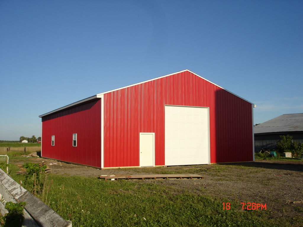

I am suprised that some people have not been able to cross cut the panels with the shears from Harbor freight. My barn is 40 foot wide on the gable ends making 80 foot of panels that were cross cut. I didn't watch them do it, but every sheet of steel came from the lumber yard with square ends and the ones on my gable ends match up to my 4-12 pitch roof perfectly and the only cutting tool the erection crew had was the Harbor Freight shear. It left little 2 inch diameter coils of metal on the ground. I would guess that the sheets would have to be cut with the finished side down because the little coils of metal had red paint on the outside.
