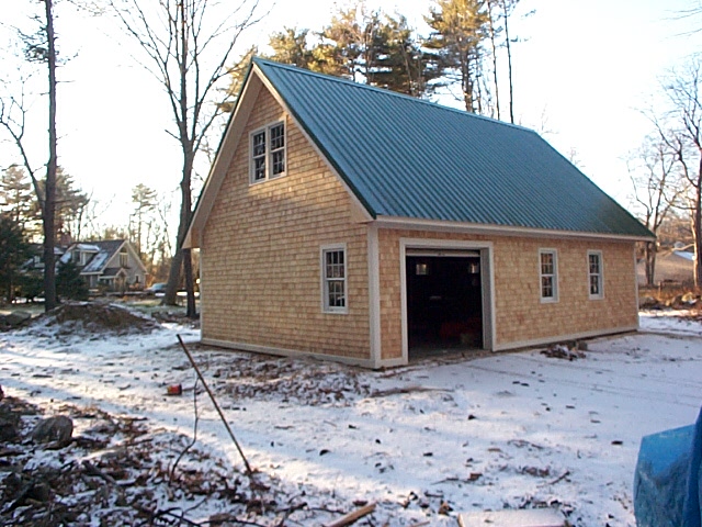

Very good looking barn. Interesting that you mention pole barns to be no cheaper than stick building. I always thought pole barns would be much cheaper so gave no real thought to stick building. Will start looking at stick costs as well.

Carl,
That's a REALLY nice barn. A couple of questions, please: did you draw the plans? buy a stock set? or have an architect draw them up? I'd like to know more about the floor trrusses. Last, I didn't realize there was that much level ground in the state.
Barry
/ Pole barn posts #24
The quotes I got were $28K for a complete pole barn with second story 24/36 incl. 4" conrete slab poured after setting the posts, and with T-111 siding not cedar shakes. This is a monolithic slab construction 18x24 "honch" with rebar around the perimeter, tied to interior steel mesh as the foundation, then 4" concrete avg in the center. Bolted to 2x6PT at the sill plate then stick framed from there.
Costs were $12 K matls, 2.5K concrete, then with my labor plus help for frame and sidewalls another $10K . The biggest cost was the floor trusses 18"x24' - 27 of them at $86 each but I don't like poles in the middle, plus wanted a 2nd story.
BTW, the previous comments about a "carriage house" aren't far off, since this is the Kubota house, plus workshop, plus storage for other stuff, which seems to grow every day..
Carl
/ Pole barn posts #25
Barry,
I did the plans, prepped the site, then per town requirements needed a signed off set of dwgs by a structural eng. So i drew up side, front and rear elevations, with framing and roof details then took to the eng. firm and they signed off with their stamp of approval.
Cost me a few $ more with the changes they wanted. I used rough EWP 1x8 for sheathing from the land clearing, but due to shear factors the eng firm wanted 5/8 CDX on the gable endwalls, and 30 lag bolts in the concrete to sill with hurricane straps every 4'.
Regarding floor trusses, there are a few types, the two I am familiar with are the I-Beam type essentially laminated wood with a 2x4 top and bottom, and the type I used which are a 2x4 truss setup. check out www.wood structures.com (based in Biddeford Me) as they make the trusses. Also some canadian outfits are very competitive as well for floor trusses.
BTW, the 18"x24"x 24' 16" OC truss setup is good for 60PSF on the second floor. See the photo for detail, also if you want a material list, I would be happy to supply one - email me.
Carl
