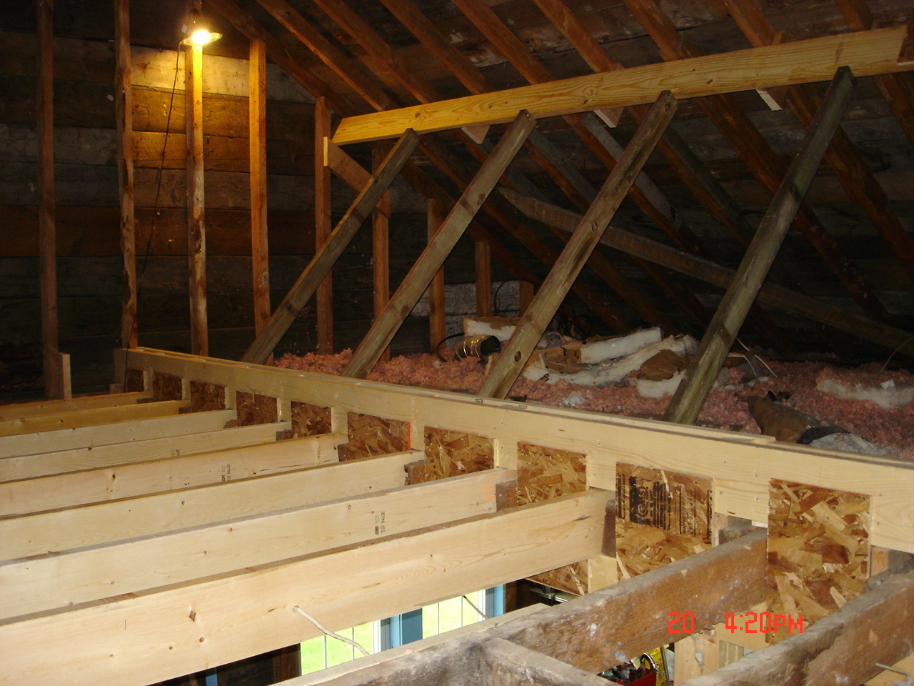

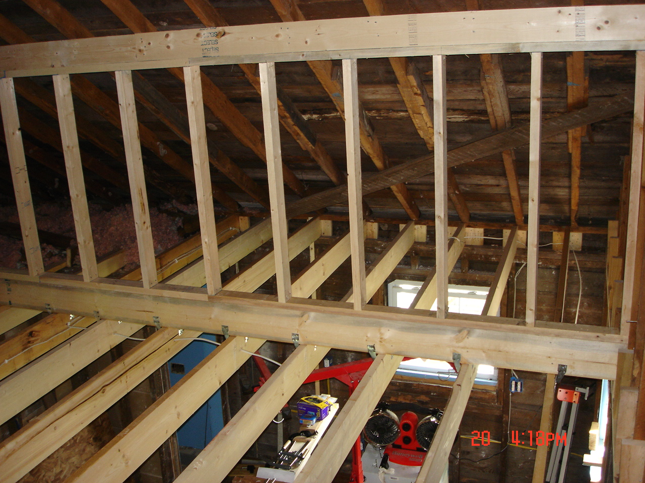

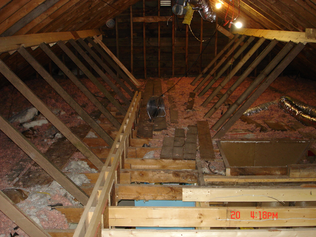

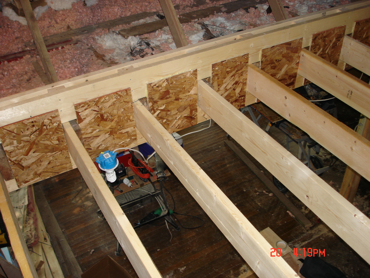

This is the way I am wanting to build my pole barn. This is a pole barn my father built about 15 yrs ago. The longest free span is 20' it may be sagging an inch or so in some spots, but not much. This is not the only pole barn like this in my area but the only one i could get pics of.

so what do yall think of the pics i put on?
/ pole barn questions #33
Looks straight, but do you think it could have used some more posts to cut down on the span?
#34
ya im only going 16 foot with my span put im going to stick frame it the same way
/ pole barn questions #35
With only going 16 foot I don't think you will need to run the kickers down to the top of the ceiling joists like the ones in the pictures. Just run your 2 x 6 joists with "crowns up" and let your 2 x 4 rafters try to stretch them. Make sure you have a good fit at the ridge board and all should be well. Use one piece joists and plate the end connections between the joists and rafters with plywood and lots of nails. Not very scientific but it works for me.
