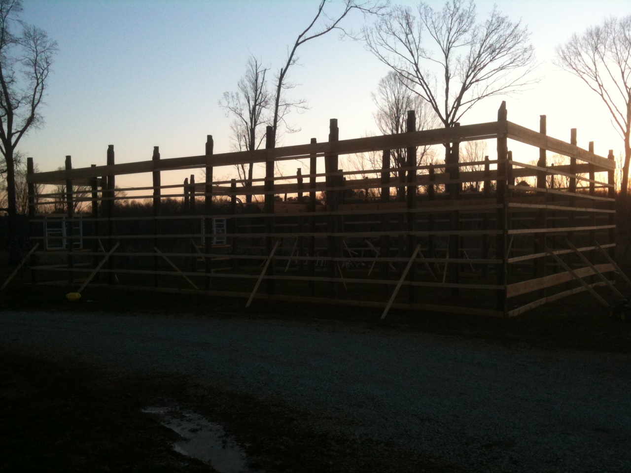

Photo of barn I took this morning:
   / Pole barn reinforcement
Thanks Terry, very good information. I've got it stabilized now with support from the outside and inside which you can see from the pics which like you said I'll remove as I need to when adding trusses and finishing outside. I'm glad to know that it should stabilize as I go. The 2x6's are a great idea. I have 20 foot 8 inch cedar poles called tier poles from the tobacco barns and also might use those. They are solid and I have over 50 of them. These of course I'd use for the cross members at the corners.

I just got a good look at the photo...NICE WORK, young Padawan...I wish I had such a wonderful source of salvaged materials..! Fine wood and history....all in one...
Cross Members - Heavier thickness steel sheeting often does not need this embellishment AND you can put it in AFTER you install the steel, if you feel the wall is not flat enough....
I am not sure how to properly utilize the round stock...but an additional 2x6 nailed perpendicularly to the top of a few equally spaced girts is known as a "strongback"...this will help flatten your walls and provide a bit more resistance to deflection of the steel in high winds...a good idea if you are using shallow rib (the old fashioned corrugated), thin material or salvaged materials for sheeting.
Run a stringline down your wall or just eyeball it and see how far out your girts have warped...a good straight strongback will flatten some pretty messy girts...screw the ends of the strongback to the girt and you can even shim if needed to flatten the run...about 4' between strongbacks is a lot of reinforcement...
