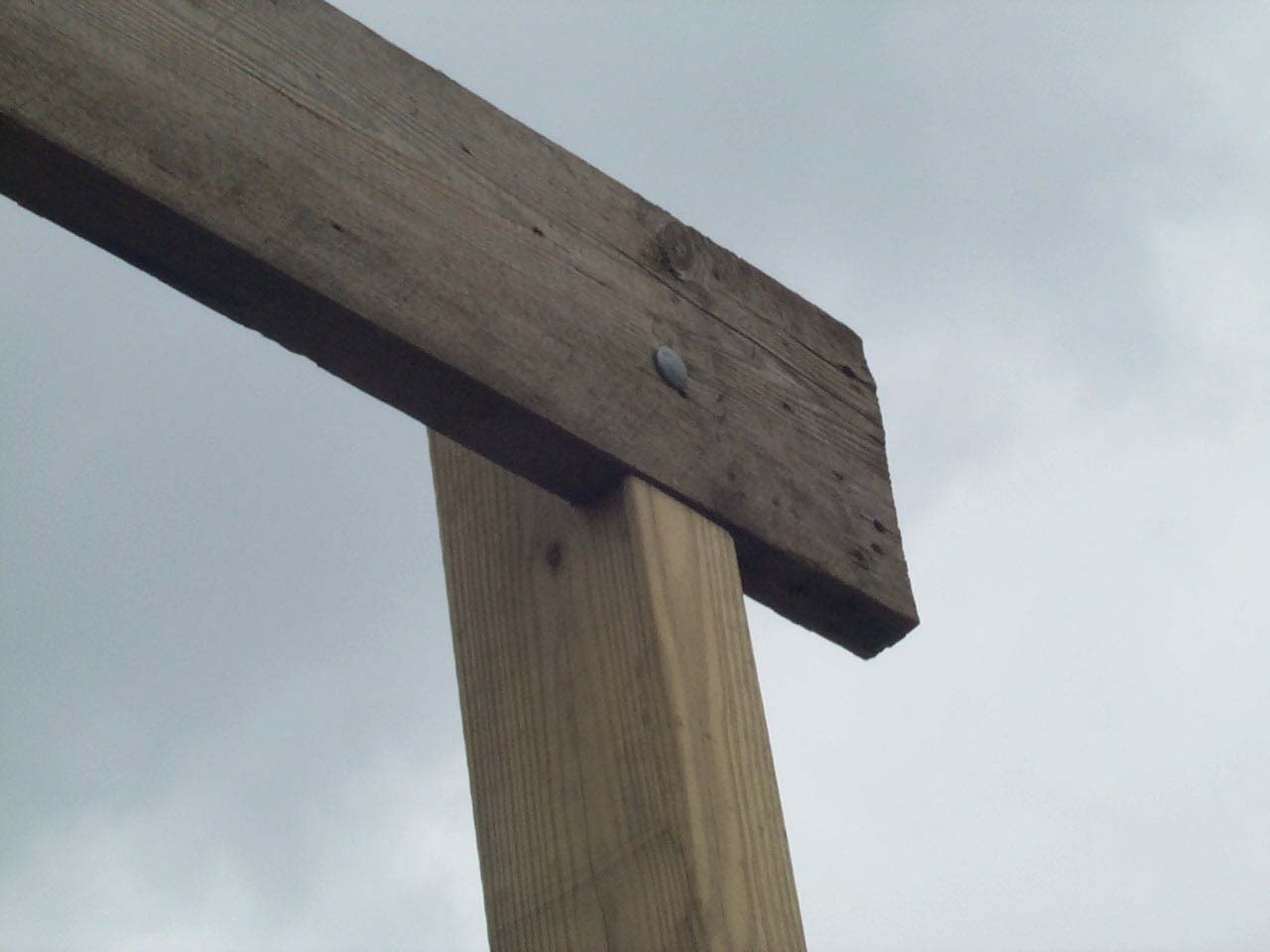

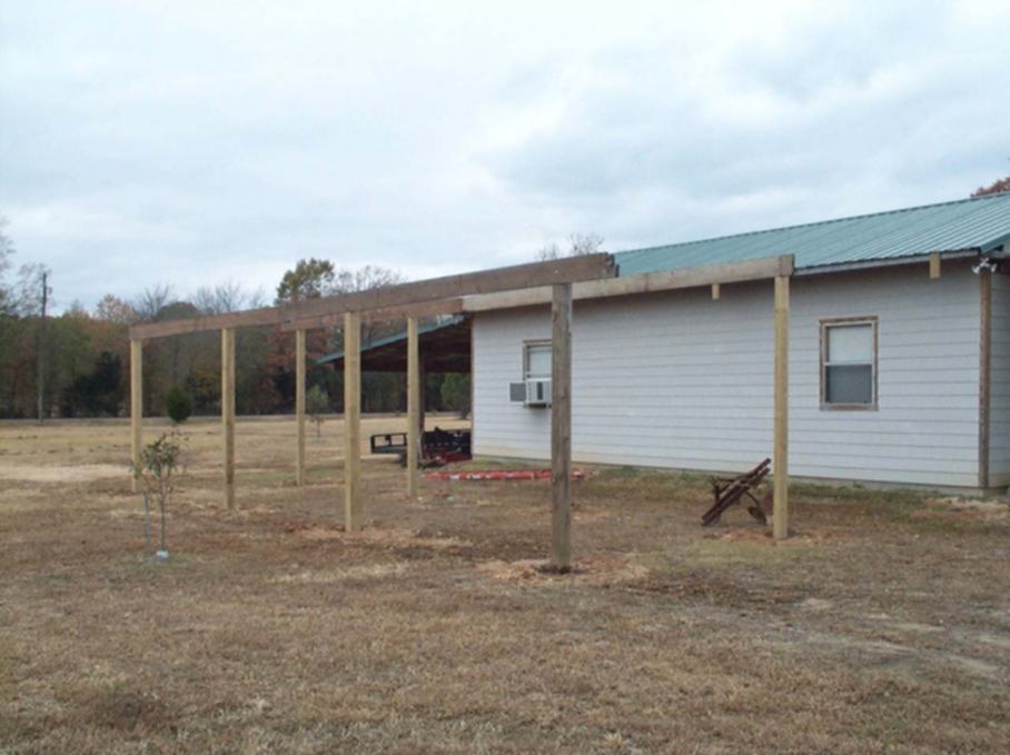

Good deal Glenn, thanks! Looks easy enough to brace up..I have 2 more questions now, ok, i am going to be putting up the truss supports(headers) tomorrow, now, i am going by this book ...Mthew logans pole barn book
I know everyone said they use 2x12 headers to support the trussess, in this book however, he uses 2 2x8's..one on the outside of the poles like normal, but also one on the inside of the poles, so even though they are 2x8's there is actually 2 of them that the truss will be setting on, in other words, the 4x6 posts will be sandwiched between 2 2x8's, surely this is as good as using 1 2x12 isnt it? Like i said, this is how he does it in his book that im going by...next question, i would also like to frame up the rough opening for the windows, but i have no idea of what the RO should be as i have no idea of what windows to use and are cheap, any ideas?
thanks Mthew logans pole barn book

Hey MOPO:
I would not use the 2x8 myself, as others said, use the 2x12 one on each side, it is not that much more cost over the life of the building but it sure will help tie it all together. My barn has 2x12 sandwitched on each side of the 6x6, but it is all wood with 2nd floor setting on the 2x12's all the way out to outside edge. then 2x12 flor joist spanning the 18 feet to the middel posts which are set on 10' centers, (joists and roof framing is all on 16" ctrs as it is getting finished off as upstairs appt some day.). the center posts have 2x12's on each side too, and the total width is out to 38' x 50 feet. it has 10' porch down the 50' side too.

I also used 2 2x12's on each side of the pole to form my sidewall girders. Technically though, it depends on the load rating required for the roof, the span of the roof, and the spacing of the poles and trusses. Any architect or engineer could easily help you determine what you need given the specifics.
