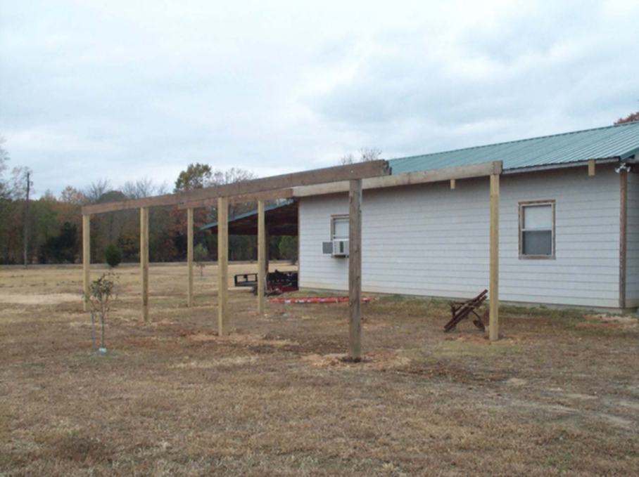

Here's a picture of a post notched as described with the header attached.
/ pole barn squareness? #30
Here's a picture of the headers attached to a row of posts. Don't get confused, because this setup is for a shed and not trusses.
/ pole barn squareness? #31
Here's a picture of my shop gable end, and the exposed board is the "show rafter". It is cut like the rafters within the truss, but to fit the pitch of the roof in the peak with a tight joint. It is supported by the screws through the lathes extending out from the building.

Sorry about that. The show rafter is not very well exposed because it's covered by the flashing along the gable edge. You can however see the lower edge.
