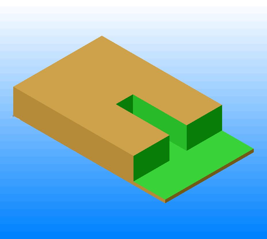

I built a pit about 15 years ago that served me well
it was only about 26" deep so I sit on a creeper and do service work under a car or park a snowmobile beside it and
stand in the pit. it was also open on the front to allow for ventilation my garage was built on a slight grade so it saved some on fill dirt as well .
see drawing
