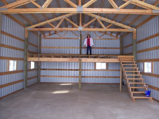

That size pole barn would cost about $2-4K for materials, not counting the floor. The methods each have their pros and cons, so you really need to look at the job and site requirements. You can go to the diypolebarns.com site to price a kit.
Speed of construction is one benefit of pole barns, which can influence labor costs if you're paying someone else to do the work. If not, that factor goes away.
Setting poles and putting up wall girts goes fast once the holes are dug, so that's not a real issue to me. It's pretty easy if you have experience. No question it will go faster than stick building for sure.
In my case, not having time to do the whole project by myself, I compared sq ft costs for pole construction versus stick building for a 20x20, and the pole barn was significantly cheaper. The crew of 3 had the structure and roof up in one day, including a short delay waiting for a footing inspection. After that was siding and trim (board & batten) which went slower. Total was 2.5 days. It would have been 1.5 days if we had steel siding/roof.
