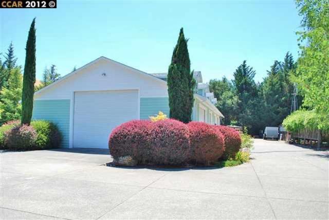

The nicest shop I have ever visited is 40 by 96... basically four 24 x 40 deep bays with a roll up door for each bay and a huge gable end roll up for the dump truck...
Stick construction and with skylight, hardie exterior for fire and sheetrock inside... all on a 8" slab....
No moisture problems, good light and sturdy with double rebar for the CNC lathe.
