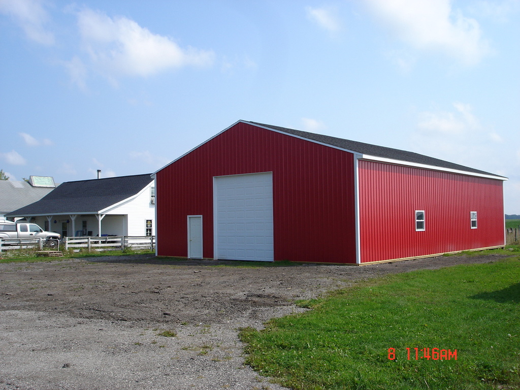

Just to throw another idea out there I built my barn and put up 7/16" OSB then did a 3 tab shingle roof to match the house and used vinyl siding and sofit. Its built as a pole barn but had to get the wife's approval on the exterior.
One other thing. Go bigger then you think you need. My barn is 32x52 primarily to make 4x8 sheets of OSB work, but I wish now I would have done deeper like 52x40. Also I kick myself for only doing 12' tall. So many things like my buddies dump truck, my boat, and friends RV, my neighbors Case Back Hoe all will not fit in a 12 footer. 14' would be so much better and I could have built a stand up loft in the rear of the barn for small item storage.

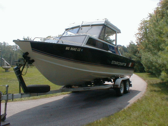

Very nice looking barn, you are right though 14 foot should be a minimum height. I had a 34 x 48 with 10 foot side walls that came with a house I bought. It drove me nuts. I had to use the garden tractor to get my 22 foot starcraft Islander Hard top boat in there because it wouldn't fit through the door if it was connected to a standard hitch. And my 32 foot Diesel motor home had to sit outside, worse yet I had to service it outside in my gravel driveway. I told myself that I would never build a barn with less than 14 foot side walls after living with that one.

That's why you need a bigger barn. Between your buddy's dump truck, your friend's RV, and your neighboor's backhoe, it's no wonder there's no room for your own stuff. ;)
No, they are never in there at the same time. Just brought in to service, or at least tried too. The problem is and I was trying to point out was the 12' door was not big enough to get any of these items in. I kick myself every day for not going 14'
Nice boat. We do not see them like that down here in Indiana.
Chris

It was just an little aluminum fishing boat. I am sure glad that I had sold it
otherwise it would have been in my barn when it burned down...:eek::eek:
It is now floating around in Colorado I am told....:)
I had it set up for salmon fishing on the great lakes and for walleye fishing on Saginaw bay. As near as I can tell my fish cost me about $ 100 a pound. But you can't buy fish like that in the store. We never caught any huge salmon, only some 25-30 lb fish. But we did drag a 15# Walleye over the transom in Saginaw bay, that thing was a hog. It wouldn't lay flat in my 100 quart cooler it was to long we had to fold it to get it in there.
It is the second best boat I have ever owned. Lightweight, lots of room, easy to launch, very easy on gas but would still run around 34 mph. And the hardtop was great for those 12 hour days on the water, and was priceless when the weather got bad.
