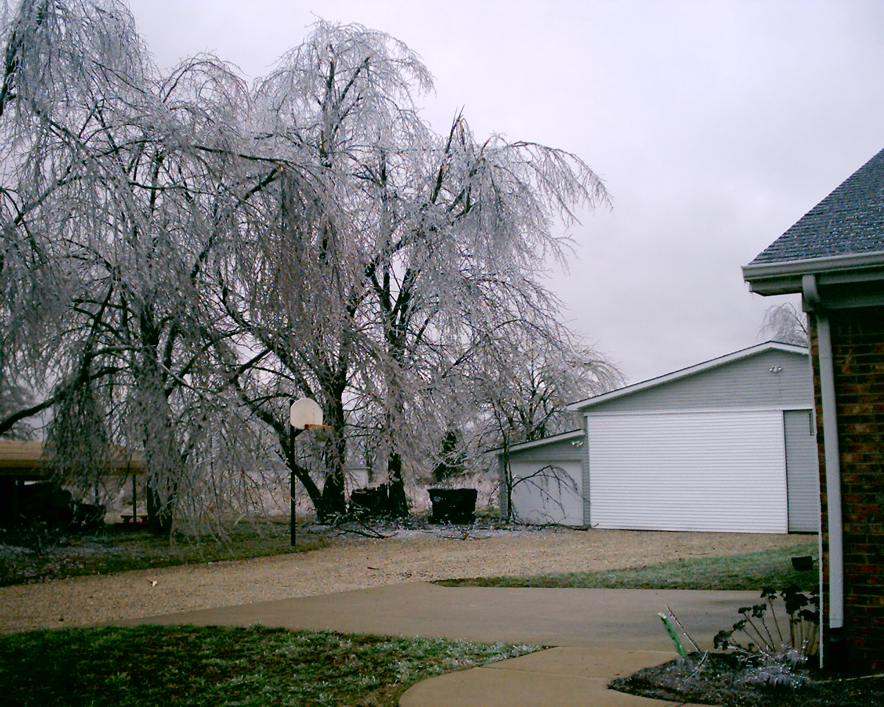

Just to throw another idea out there I built my barn and put up 7/16" OSB then did a 3 tab shingle roof to match the house and used vinyl siding and sofit. Its built as a pole barn but had to get the wife's approval on the exterior.
One other thing. Go bigger then you think you need. My barn is 32x52 primarily to make 4x8 sheets of OSB work, but I wish now I would have done deeper like 52x40. Also I kick myself for only doing 12' tall. So many things like my buddies dump truck, my boat, and friends RV, my neighbors Case Back Hoe all will not fit in a 12 footer. 14' would be so much better and I could have built a stand up loft in the rear of the barn for small item storage.
Sorry, no good pictures, I am on a backup computer.
Chris
Very nice looking barn, you are right though 14 foot should be a minimum height. I had a 34 x 48 with 10 foot side walls that came with a house I bought. It drove me nuts. I had to use the garden tractor to get my 22 foot starcraft Islander Hard top boat in there because it wouldn't fit through the door if it was connected to a standard hitch. And my 32 foot Diesel motor home had to sit outside, worse yet I had to service it outside in my gravel driveway. I told myself that I would never build a barn with less than 14 foot side walls after living with that one.
