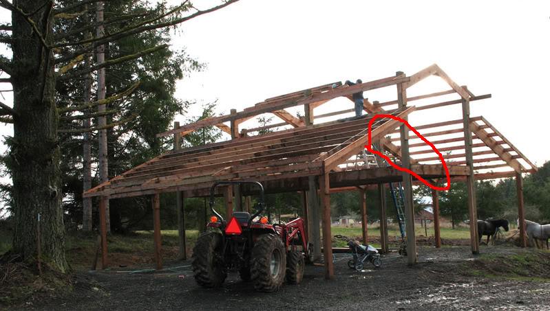

I follow your logic. It appeared to me in the picture I posted that the board size for the purlins was 2x6. The mains look around 2x8 or 2x10. I thought I was using overkill by 2x8 purlins and 2x10 or 2x12 mains.
I figured I could get some input to this method on this site before spending $15 on the download for the "secerts". But if the board spacing and sizing is that far off , then it will cost as much as using trusses.

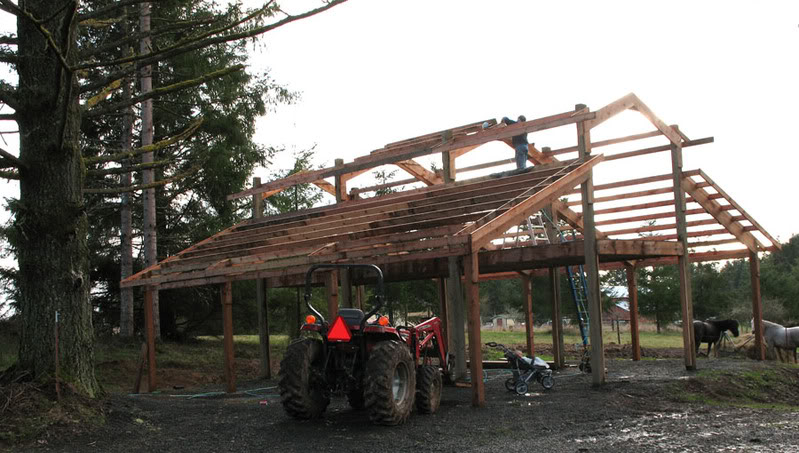

This is one of the few that seems to be using a similar build design. Now his spacing is around 12' I think. My design was similar just not the center section. This is steeldust photo from his thread.
It looks like you are close with the spacing @ around 12', BUT, it doesnt look anywhere near a 15' span though. It looks like maybe 10' at the most.
AND it is hard to tell, but it looks like the middle sections are a DOUBLE 2x12. See pic.
The middle two "beams" will have to support twice the load as the end beams. Because they have to support the roof on BOTH sides half way to the next beam. The end beams only are supporting roof on the one side, not counting a small overhang.

Off topic. I just noticed that it looks like his kid is laying in a stroller while he is working on his barn?? Too funny.
Not sure about his spacing, but it looks very sturdy. I think I will re-read your thread as I found out over the weekend that I think the covenants will require it be enclosed. How much did you have invested in your build?
