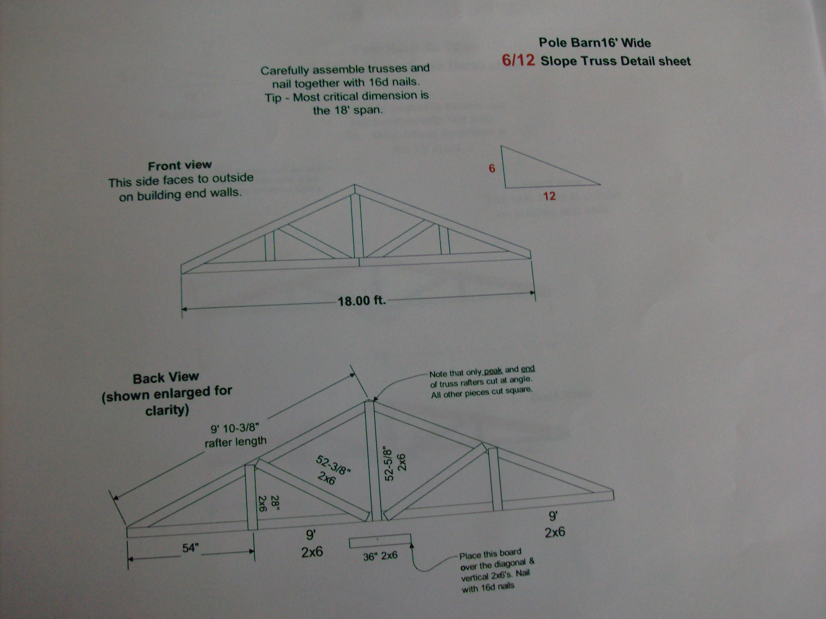

I was wondering about using 2x4 lumber to build the trusses as attached in the drawing above ?
I looked @ a roof rafter calculator and your numbers seem correct - 16' will be a little short for 5/12

Building a truss is not rocket science. Go to a place that sells them. Look at their 30' trusses. Take note of the size of the top and bottom cords as well as spacing for the webbing. Just copy a proven design. It really isnt hard.
And sizing rafters isnt rocket science either. A 15' rafter span, L/180 limits, 24" on center, white pine, 30psf live and 10psf dead, minimum requirements are at least a 2x12.
A 2x8 would only span 11' with the above specs. So I DO see a need to go larger.
Your other options aside from a truss would be a 2x10 on 19.2 centers, or a 2x8 on 12" centers.
Spanning 30' is no easy task for rafters. Trusses are much better. And more than likely, cheaper. A Standard 30' W truss on 4' centers probabally uses nothing larger than 2x6's, and would probabally be cheaper to build than the cost of MANY rafters that require larger lumber.

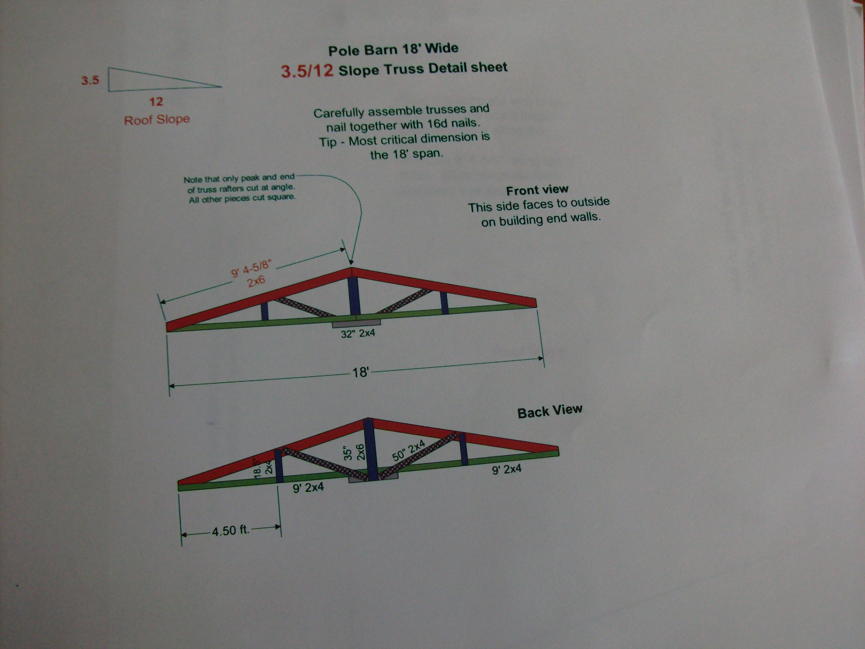

Hopefully the pictures help i could not send them from my i phone.By the way i changed the design a bit.

There ya go ... I guess the webbing doesn't have to be angle cut and use plywood for a gussett ... just cut them to length and nail them along side the top and bottom chord.
