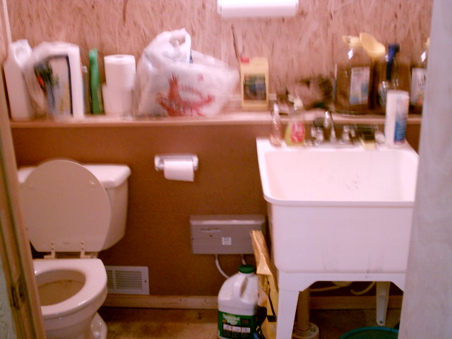

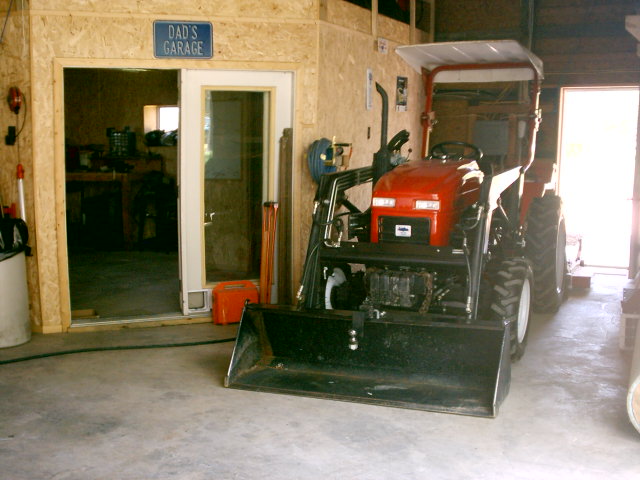

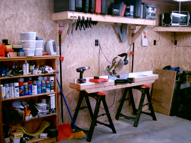

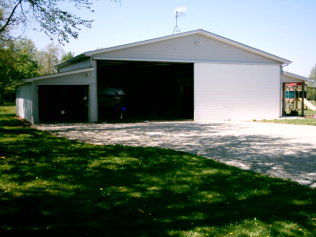

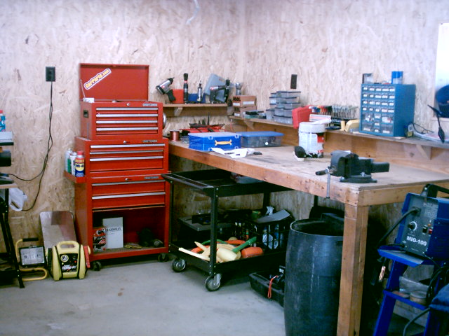

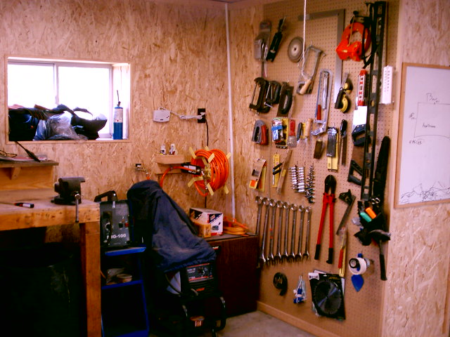

Here in Northern Indiana we put the purlins on end also to handle the load. I built my barn in 2003. Its 32x52. Did it that way to handle 4x8 sheets since I used vinyl siding and dimensional shingles. I did a 16x20 shop that is heated by electric along with a bath room and a on demand water heater. The only thing I kick myself over is not going 14' tall. I only went 12' and there are tons fo things that will not fit through the 20'x12' slider.
By the way you guys have Very Nice buildings!

That's a very nice building and great pictures, thanks for posting. First time I've seen the purlins on end like that.
I thought this was interesting: According to R. Bruce Hoadley, "Understanding Wood", load bearing capacity of a beam will vary directly as the square of the depth. In other words, if you double the depth, it will carry four times as much weight.
You can tell the guys who live in snow country, it amazes me how many buildings I see with the doors under the eaves, instead of in the gable ends like yours.

I see you have a Stanley cross cutting guide hanging above your miter saw. I have one also. It is the best piece of plastic I have ever purchased.:D

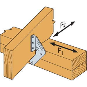

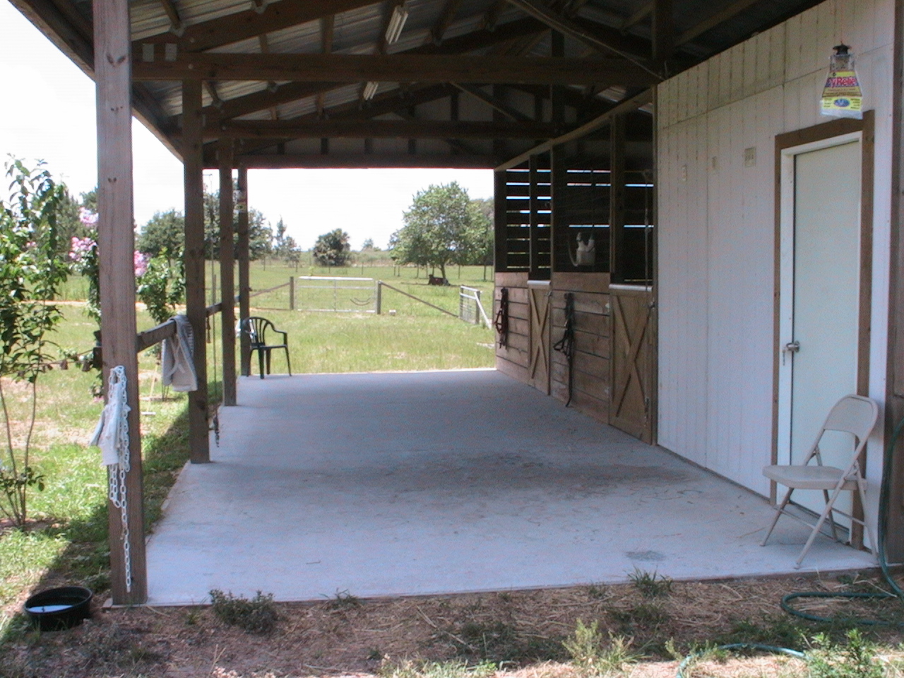

As far as putting purlins on edge, I built my previous barn that way (only half the size of the current one) when I lived in Florida. All of the purlins were connected to the trusses with Simpson H1 brackets (around $0.70 each at HD or Lowes). I did this primarily for hurricane resistance, but they worked great for keeping the purlins upright. You might even be able to get away with just one bracket per purlin and just toenail the rest of the purlin/truss connections, especially if the purlins overlap each other so they can't twist independently.
Here's a shot from underneath on the my old barn, where you can see the brackets I'm talking about.
