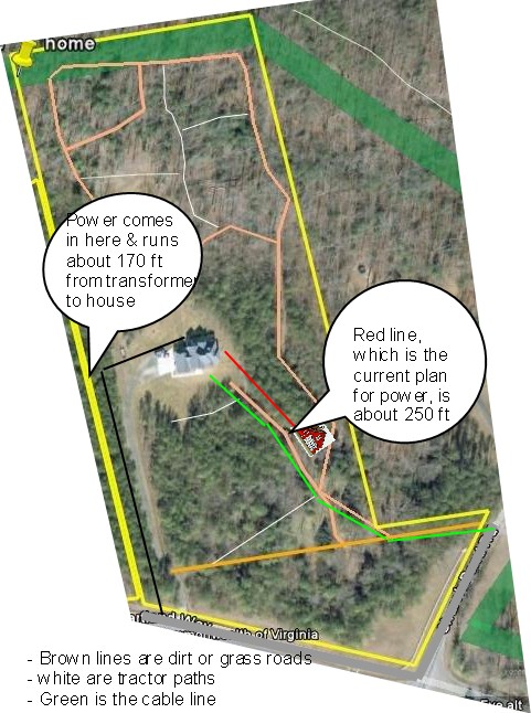

Where does your electrical service come into your property relative to where you are planning this building?
In my case, the supply came up from the road roughly following the drive to house. When I had an existing pole barn and a new metal horse barn wired we excavated and tied into the supply line under ground* near the project. My electrician was concerned that if we came from the house and back to the new service there would be capacity problems. It also saved material and was a lot simpler job. He earned his money with me right there.
*The connection was made in a Traffic box.
The transformer is about 500 to 600 feet away on the otherside of the property. see pic.
