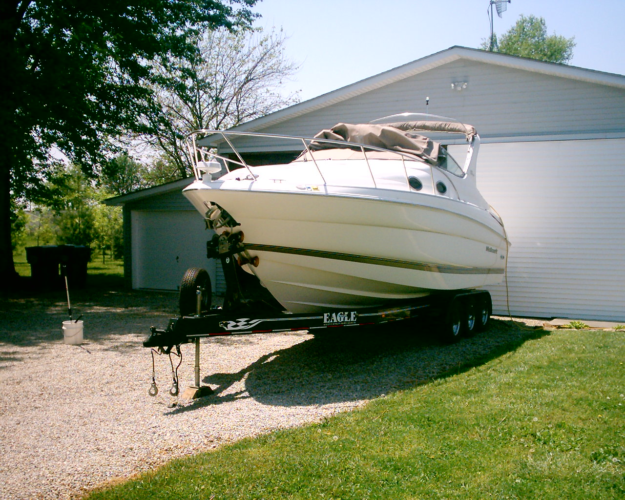

We built my buddy a barn that was 10' high and 30'x60'. He said it would be plenty. Now he owns a dump truck and a dozer along with a camper and none will fit in. So 4 years ago I was going to out smart him and build a barn with 12' high walls and 32'x52'. Worked great till I bought this boat, 13'6" tall. As you can see my baby now sits in the drive and I have to pay to store it in the winters. My point is do not mess with anything less than 14'. That is what is allowed to be towed down the road, ect so it will fit in your barn. I tell guys to make it 14' with less sq ft then put a loft in the back of it, you will have the height and have more storage space.

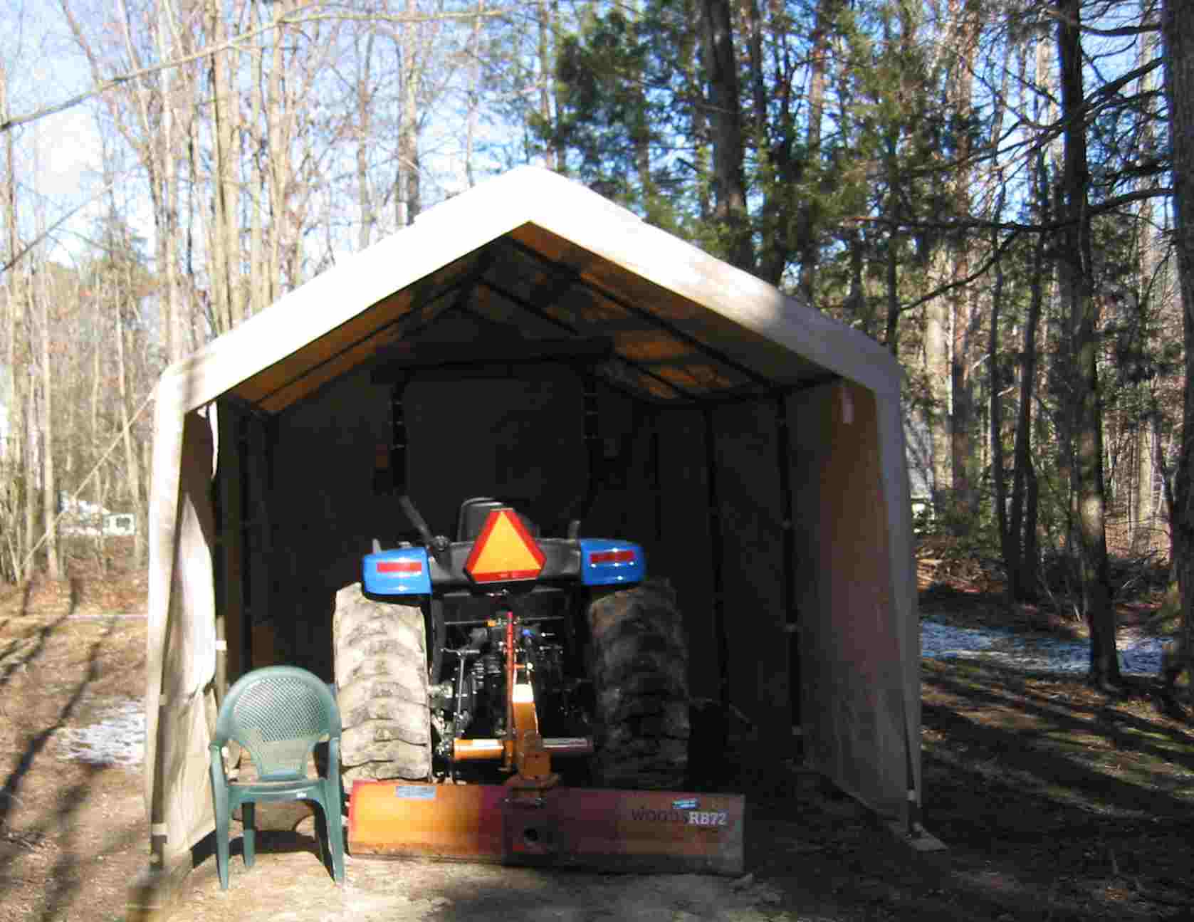

My grandpa builds barns like that for a living. If only I knew the price that he would estamate. Good luck! So, is your tractor sitting outside?
No its in a tent

Good looking garage but that is an odd ball looking tractor! ha.
Chris
If the ROPS on the boat would fold down like they should I think she'd fit fine.:D:D

   / Pole building Estimates #25
Wedge
Trust me, I have thought of that. There is a place down the road that rebuilds Corvettes and he said he could do the fiberglass work needed, but after a few measurements I realized the windshield was 4" too high. It does not look it but the height difference between the Radar Arch and the windshield is only about 12". The only way I could get it in is either make the arch fold down and put on wheels with no tires to back it in for the winter or leave the arch as is and go with wheels and no tires and lift the tongue of the trailer about 6' in the air to dip the arch in between the trusses. Not a easy task for my FEL since the boat has about 1,800# of tongue weight and weighs about 15,600#. I do not want to risk it so I just leave it sitting in the drive. My dad said to dig a basement.:D
Chris
