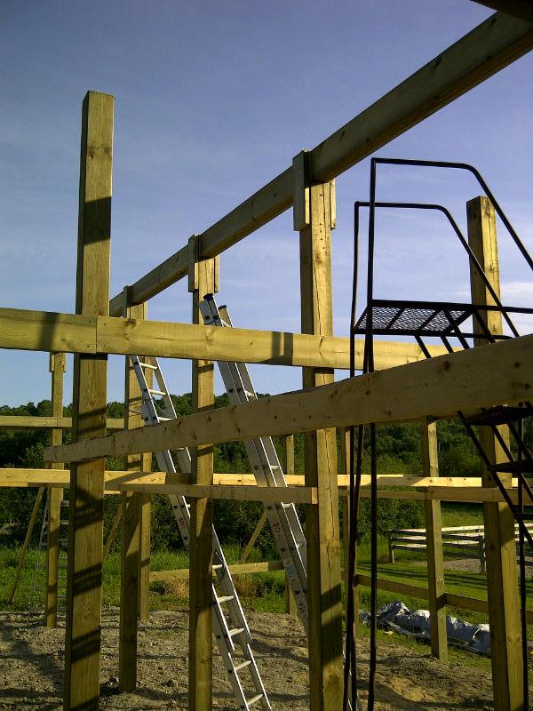

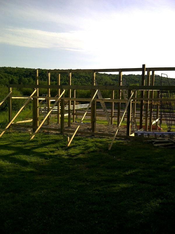

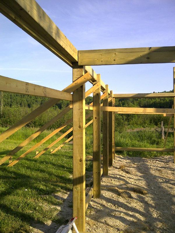

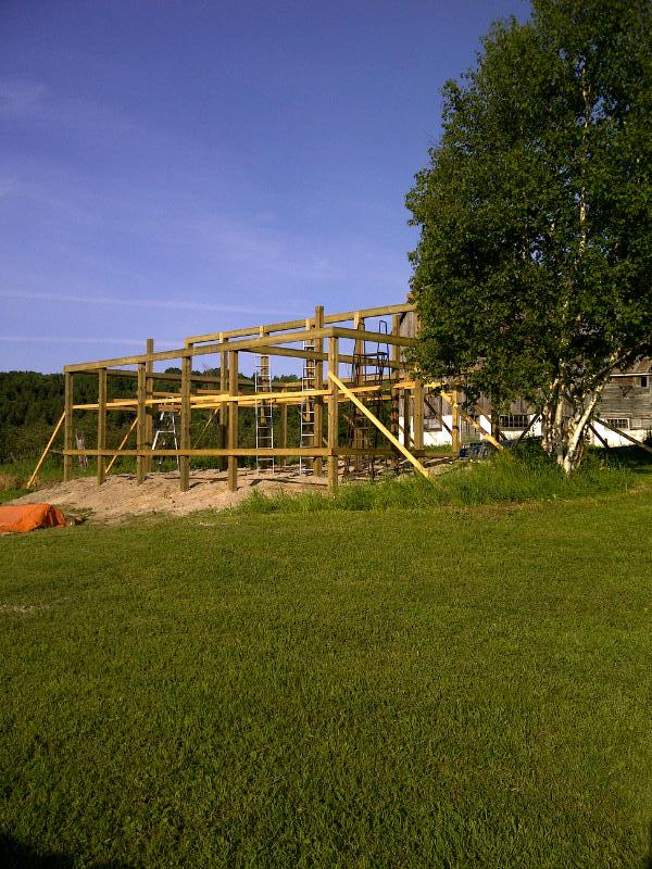

Hi Folks, here area few pics of my in progress project, my son (13) and I are building it. Thanks to all the good folks here for the tips on putting up the ridge beam, we got it up (amongs other things) this weekend with no trouble by building in place. We made "saddles" at the top of the 12' posts to hold the ridge beam.
Ill be bolting the beams to the 6x6 posts next.
You'll see lots of temporary 2x4 bracing in there too at the moment, that will come out later after all the walls etc arre properly braced
