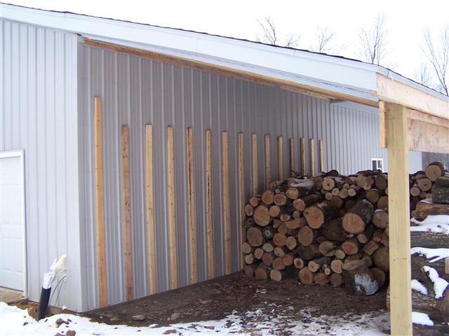

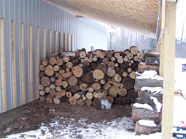

/ Polebarn lean-to posts #22
Thanks for the pix, Rex. Thats very close to what I want, except my connection to the barn is to an end wall.
