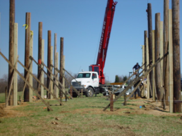

I know that our building code calls for engineering certification for walls on pole buildings that are over 14' tall because of potential wind sheer problems (i.e., a strong wind could cause your building to fall over). If I were you I would definitely have a talk with your building inspection department before I would put up the 16' walls with 6 by 6's.
I was worried about wind shear with 18' walls. These are the posts I used. 12" diameter utility poles with 18" diameter bases 6' in the ground on a 2' x 8" thick footer. 10' OC. Yes, I do store hay in the loft. Approx 1500 bales.
DW

   / Poles for Pole Barn Sizing #26
Hey Guys-
I looking at having a 16' sidewall height.
Do you guys think the 6x6 is a big enough post for this application?
the sidewall height and design windspeed and on center post spaceing is the determining factor for post design. (horizontal wind load on the building generally exceeds the gravity load especially in wall heights over 12')
6' OC perhaps 8' OC is likely pushing it 10-12' OC .... not on my barn.
