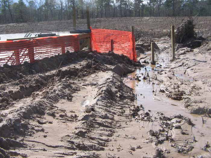

The grow out pond above the main pond is about 50% complete now. The fish fence posts are set and part of the fish fence is in place. The fish fence is composed of fine mesh galvanized chicken wire augmented by plastic barrier fencing which should last a lifetime(in case the galvanized wire does not).
Only about half of the grow out pond is currently fenced and the other half will be left open until the main pond water level backs up to the grow out pond. In the meantime, a few dry days might enable some more digging out of the grow out area. Fish stocking of the main pond is next on the agenda and will begin after the Holidays. Happy Holidays to all!!!

I like the use of the orange fence material. That should last forever!!!

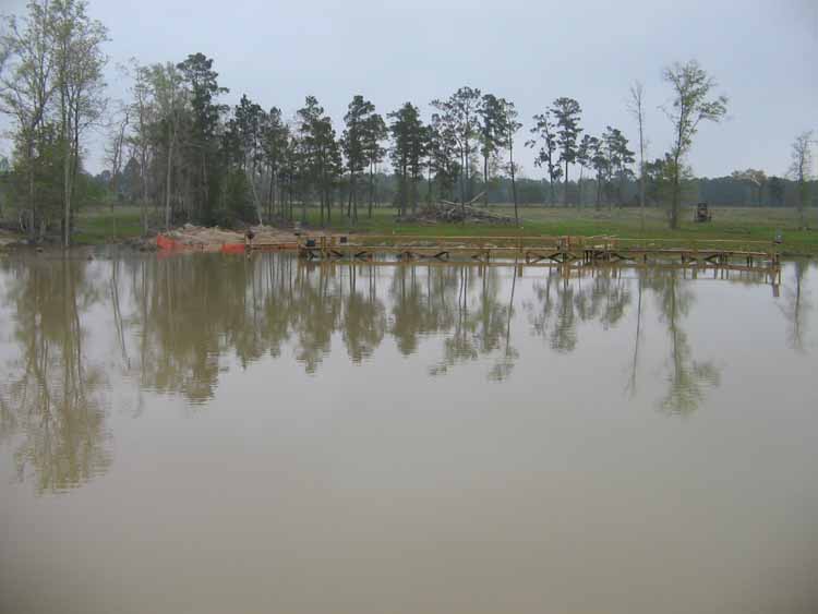

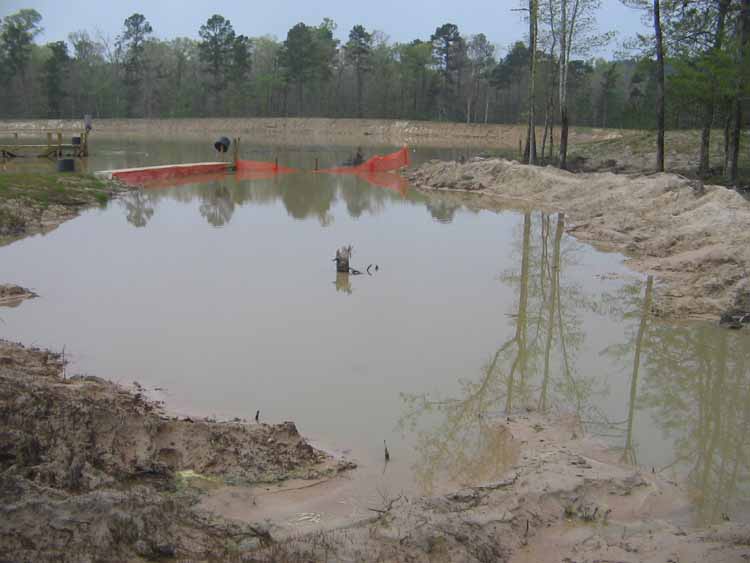

Several folks have asked how this pond turned out, so thought I'd post a couple of pictures....one from the dam looking back at the pier and another viewing the growout pond. Its about 4 inches short of full pool and fish are active.
