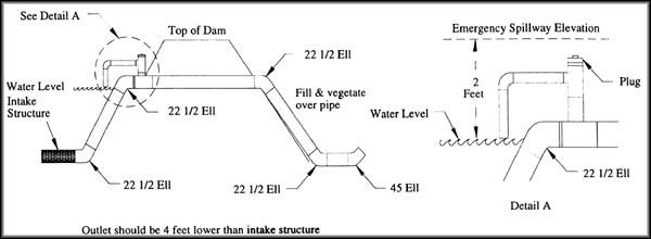

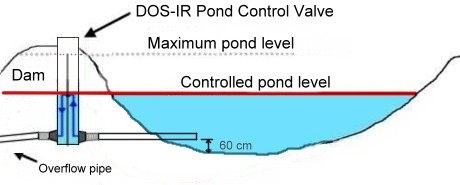

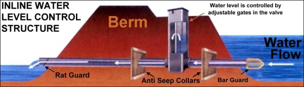

Anybody have any good links, pictures, ideas about products or designs that would let me adjust the height of a pond from about 6' to zero, and all heights in between? At max spring flows I need about a 12" pipe to handle the flow without relying on a spillway.

Some good info here: Conventional Pond Piping System
Another way to do it: Anti Seep Collars and Dos Ir Water Control Overflow Valves Aquatic Biologists
inline_valve_EN.jpg Inline Water Level Control Structure
