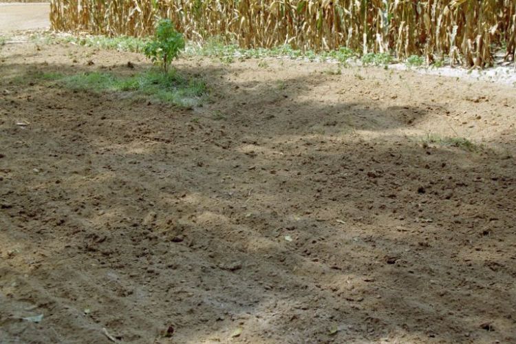

Ok here are a few more pics. I still have many more to come. This is an area close to the pond that I just tilled. Just posting a pic of what a great job the tiller did.

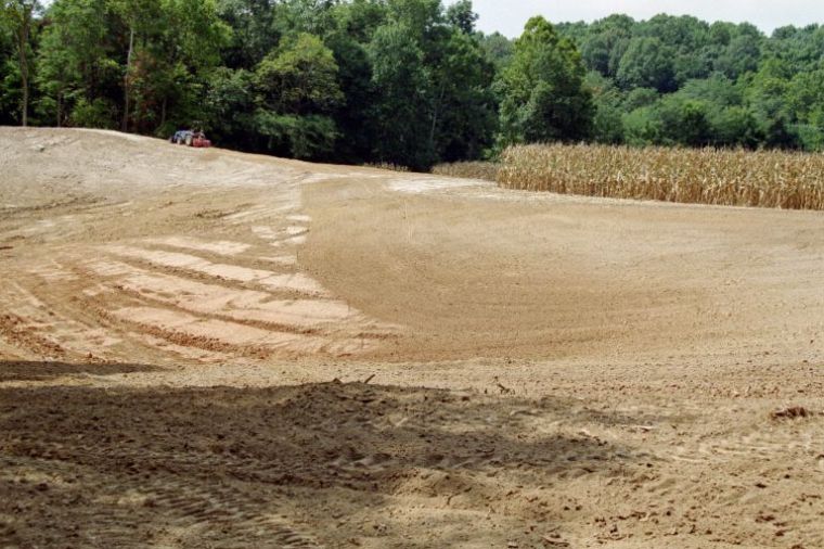

Here im tilling the inner portion of the pond. The line that you see where the tilled soil meets the hardpan, that is about where the waterline will be.

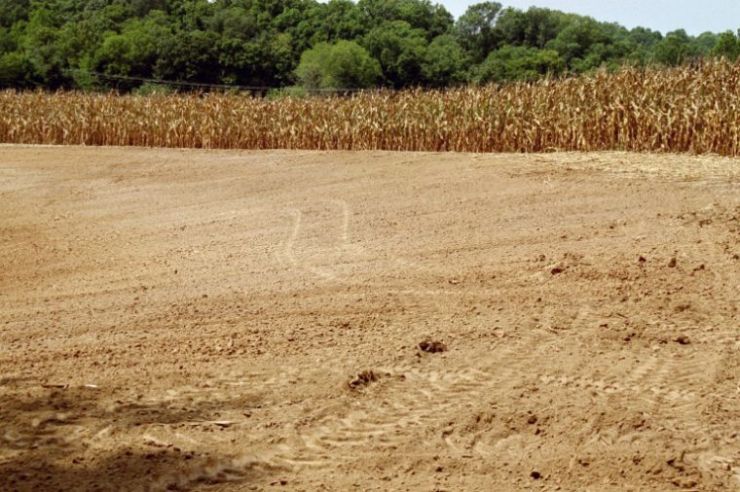

Another area just tilled. The corn is ready to pick too!!

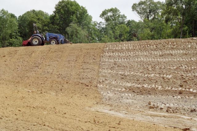

Here I am tilling the back side of the dam. You can see here what a nice seedbed the tiller makes. However, especially on a dam, its important that you wait until the end of september (In my area, Southern Illinois) to plant if you are going to be using a tiller. Because the tiller makes the soil very loose, and if you were to get a heavy rain, it would make big gullies fast. Around here, the chances of heavy rain after September are slim to none. You can plant earlier if you are going to be using a disk. Just a little tip that the Soil Conservation Office gave me. They are in charge of this whole project by the way. They are funding 2/3rds of it.
