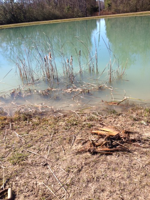

I Any new trees beginning to grow on the pond bank as well as cat tails should be removed.
If cat tails are not controlled they will soon take over your pond.
A few cat tails started last year on one end of my pond that has a gentle slope. I didn't bother them last year because I liked the "natural look" that it added to the pond. But I don't want them to take over. What is the best way to get rid of them ? Just pull them up ?

I believe they make some kind of herbicide not harmfull to fish. Cattails have an elaborate root system and I am suspect that pulling them would kill them off but maybe. While you're in there...look for snappers!

If you have a BH or ex dig them ALL up, if all you have is manual labor "pull them ALL up". Years ago when I had my 1st pond I liked the idea of cat tails so I figured " ah it's just a few plants I'll let them go" The next year pond was overtaken. Now I keep them under control, I'm also not writing cattails are horrible they do provide filtering. If you have a way to leave a few, keep them from taking over, it won't hurt. This is the reason (atleast in this area) most ponds have a 3 to 1 drop but at the edge we try to start out at 3 foot. I have seen folks use a lime edging but I personally don't have any experience with this. I also strongly disagree with ANY type of chemical attack. Once cattails are knocked down they are not that hard to control, with minimal elbow grease.
Really appreciate the heads up on the cat tails . Those things grew like crazy. Water is high right now so very difficult to get them up. I found a little sharp shooter shovel worked best. I will just continue to knock them down with the bushwacker blade on my weedeater. I read as long as you can cut them down
just above the water line they will die eventually, so that is my plan of attack. Attached is photo, last year there was only a couple cattails.jpg
