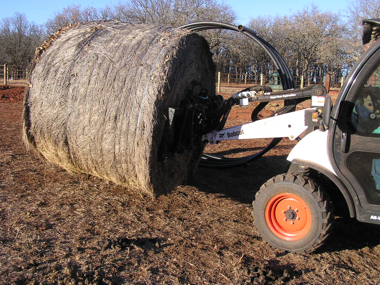

Hey, Hay Dude! I am very happy with our 5610 F series. Only have 64 hours on it, so is barely broken in.
The cab is great! 4 wheel steer is great! :thumbsup: You probably have seen my threads here in the Toolcat Forum, but I will answer some of your questions.
It handles 5x6 round bales, no problem.

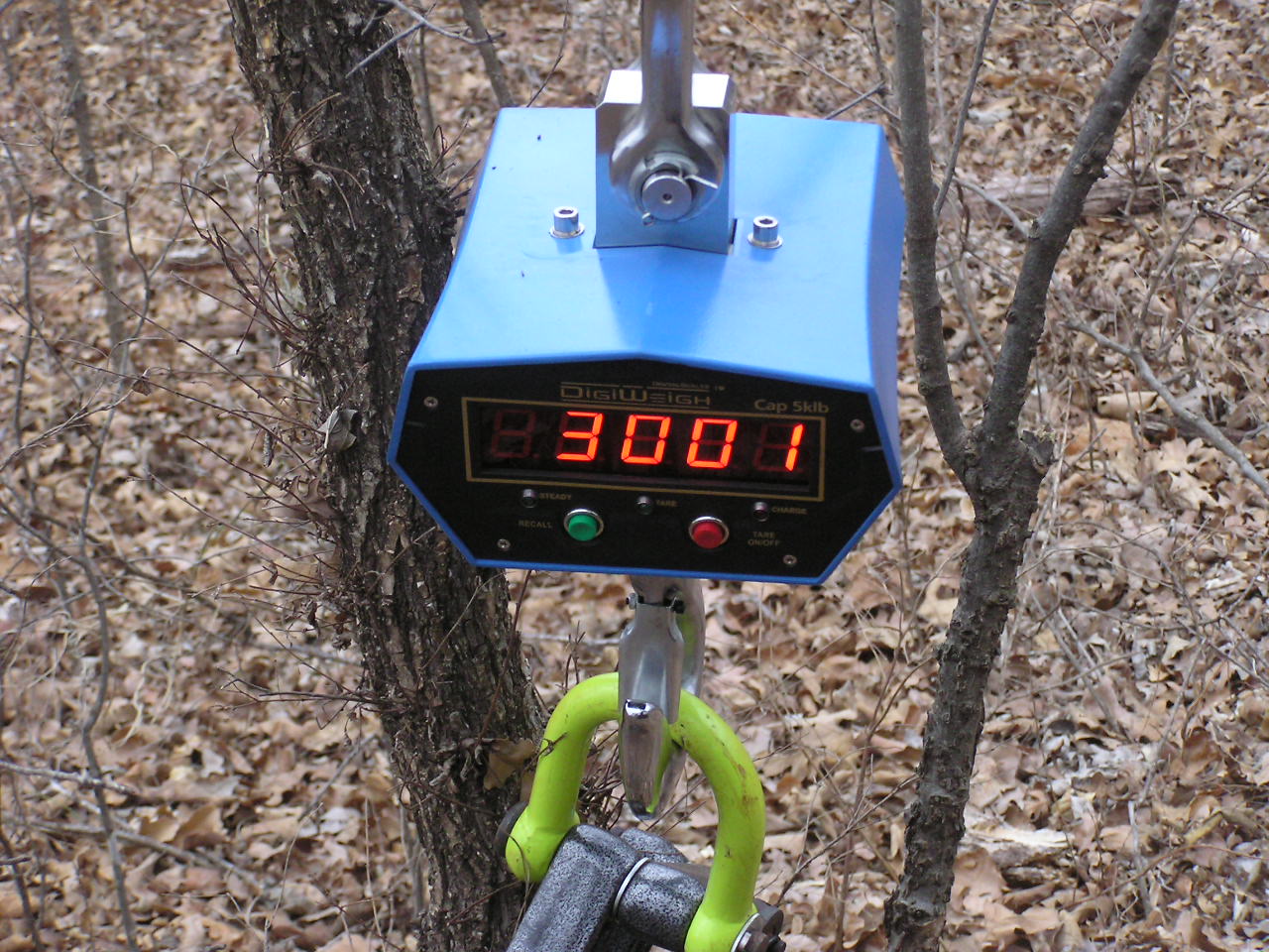

I hung the scale on the bare SSQA and chained it to a tree, showed 3001 pounds of lifting force.

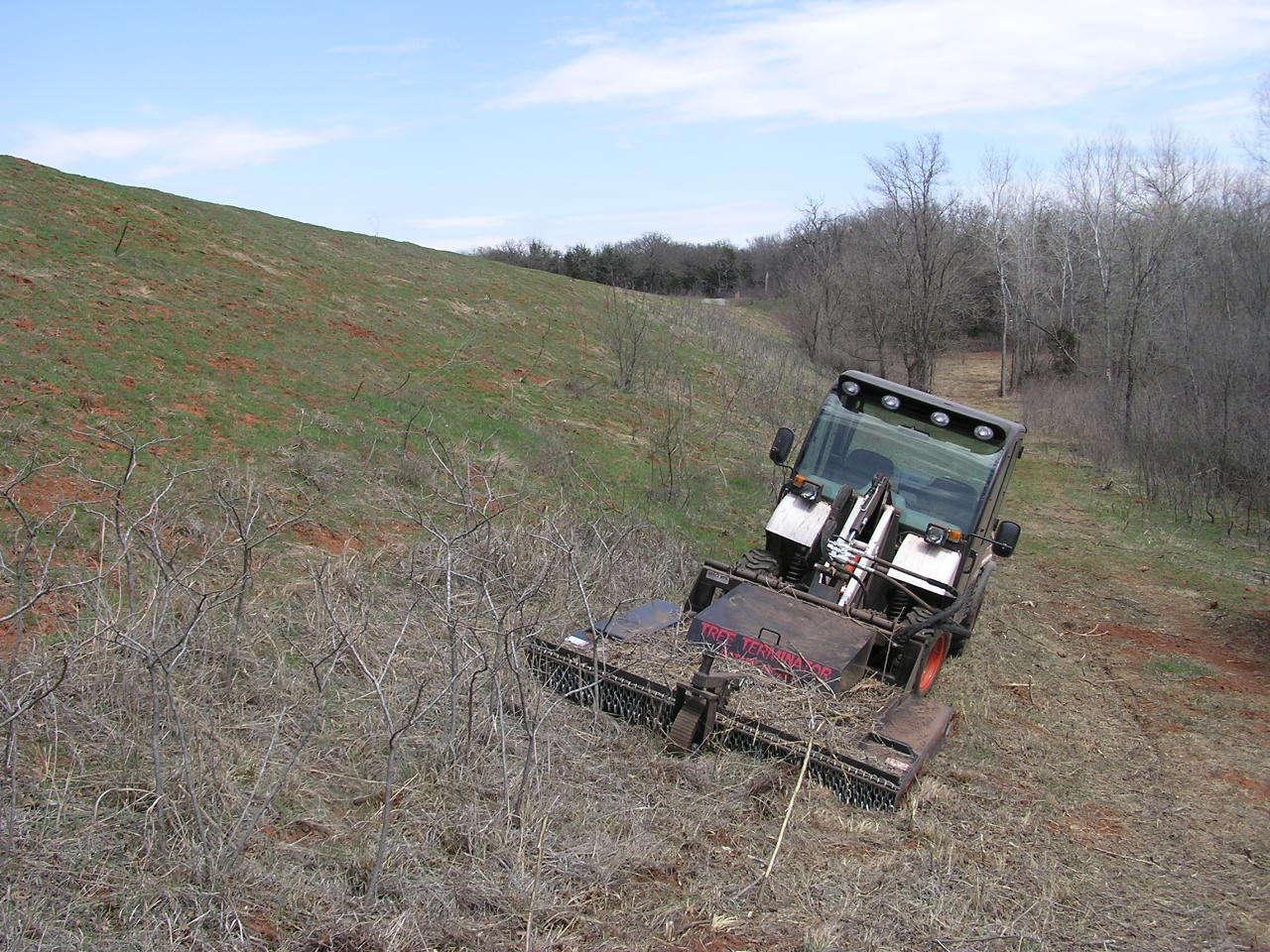

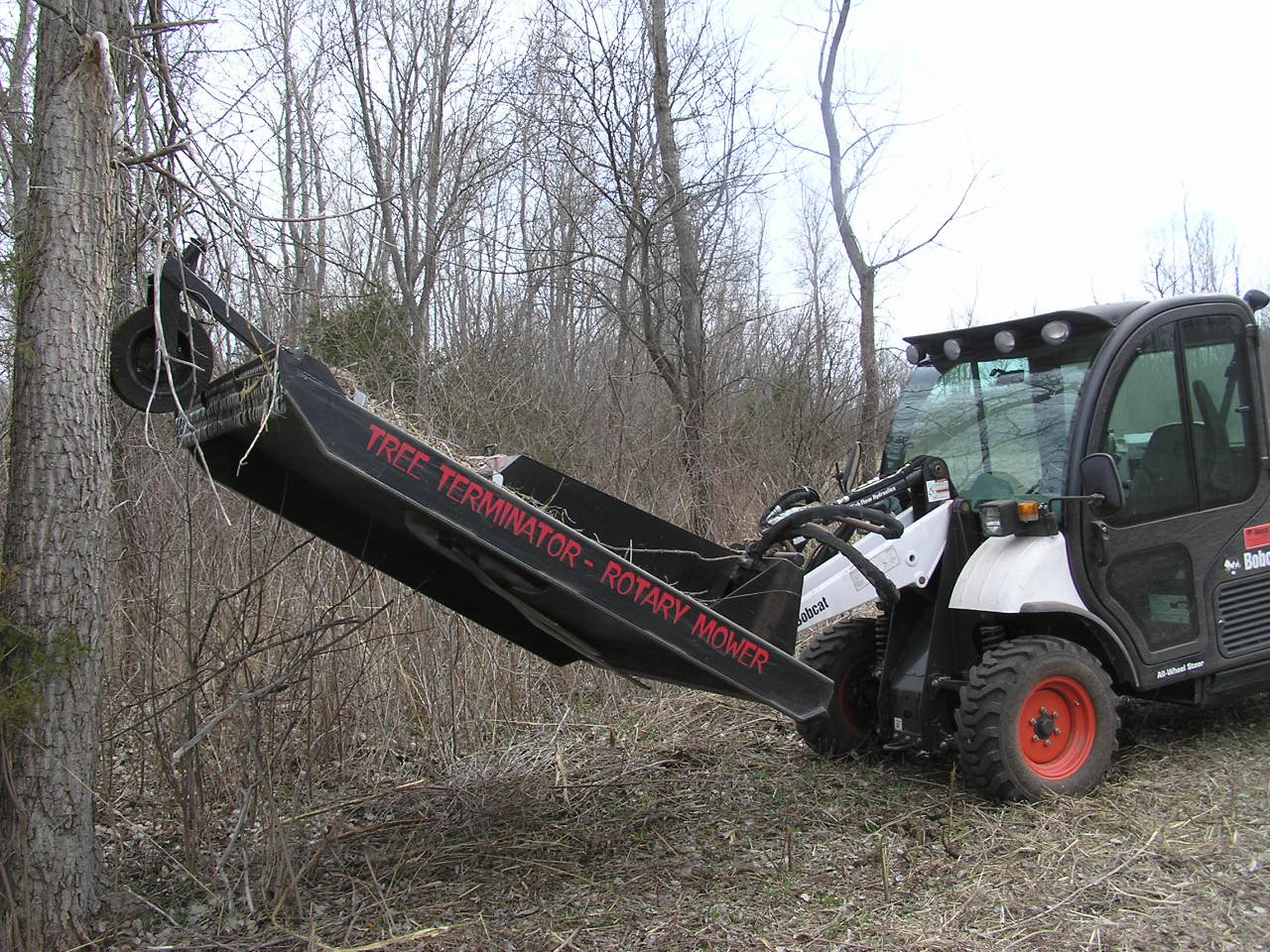

No experience with the 90" finish mower, but just put the boom in float mow in comfort, with it out front where you can see what you are cutting.
It is very stable on steep side hills.

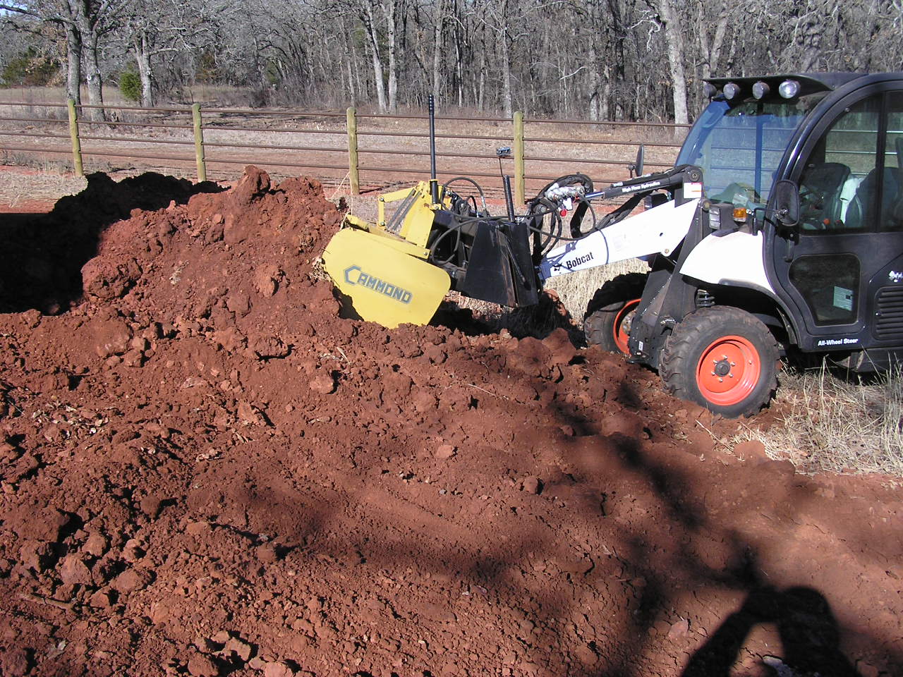

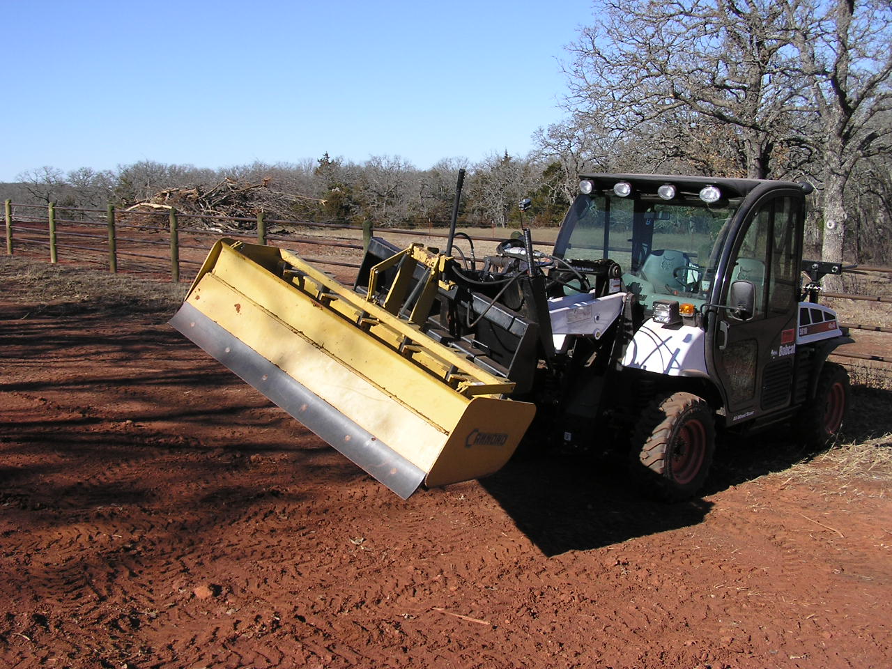

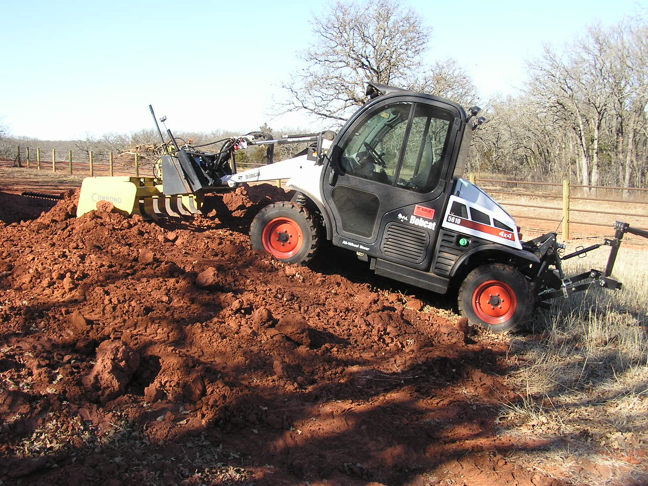

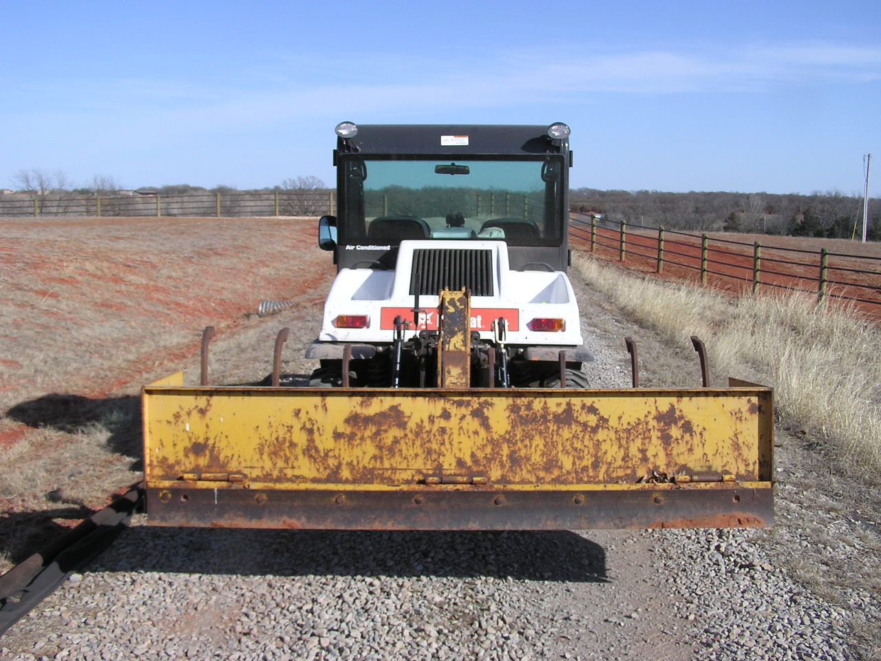

It will handle 3pt implements on either end! :D

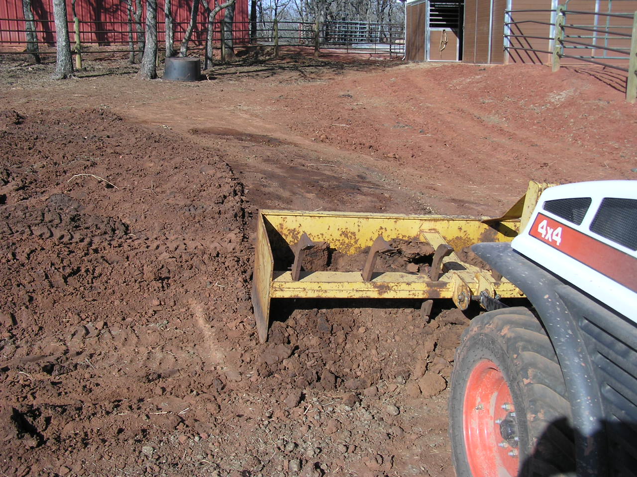

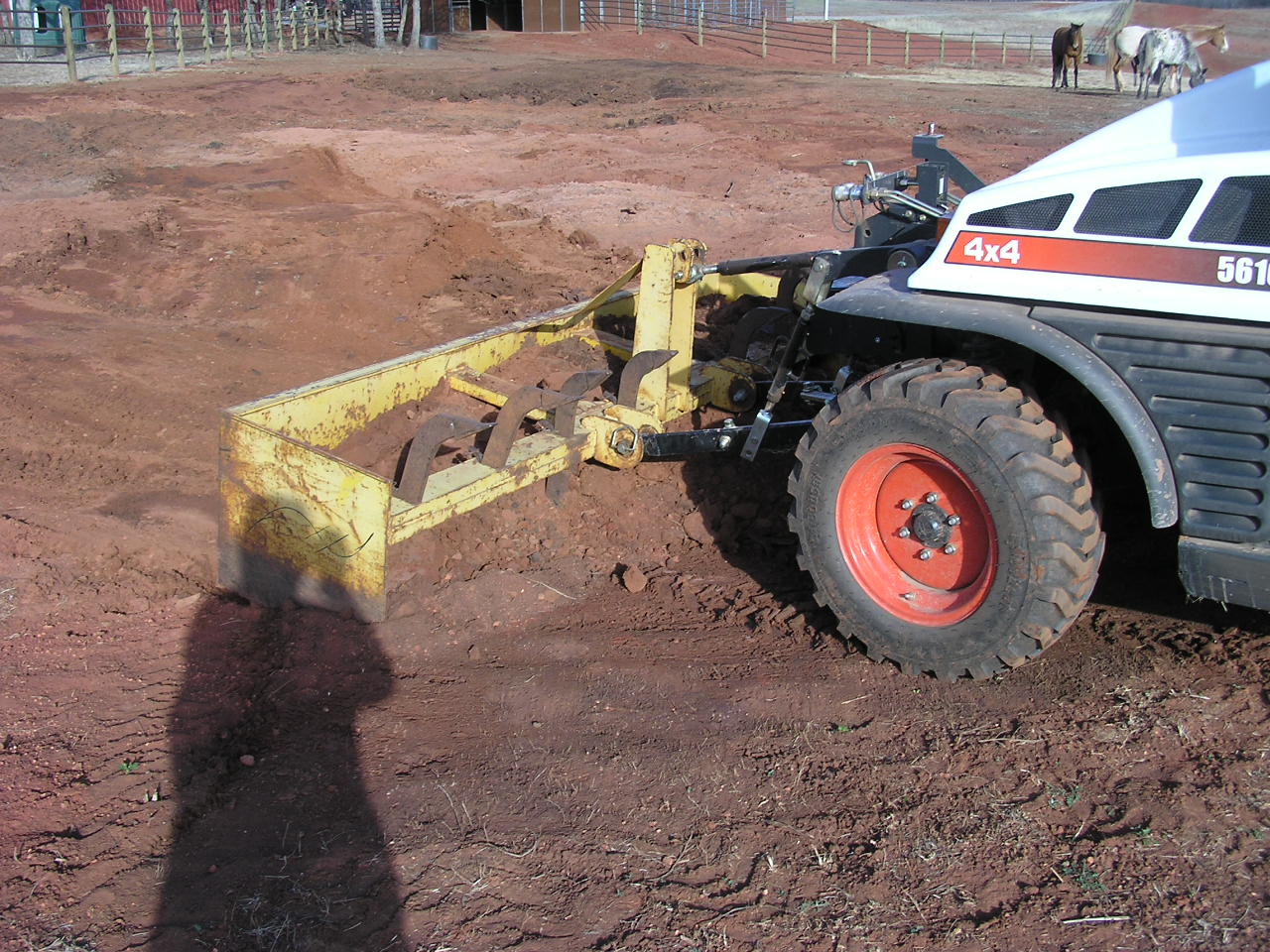

6' on the front

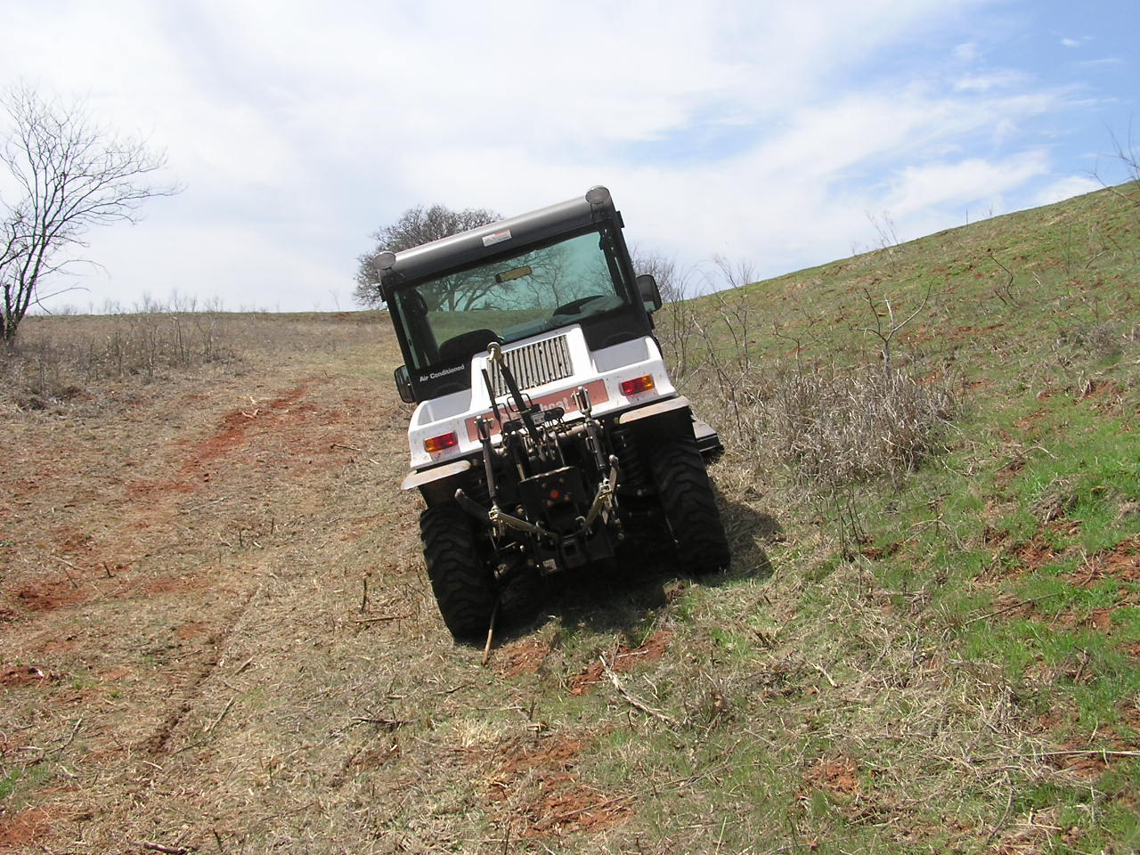

8' on the back

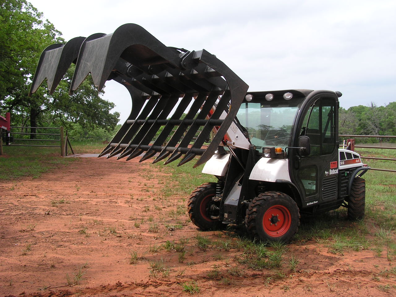

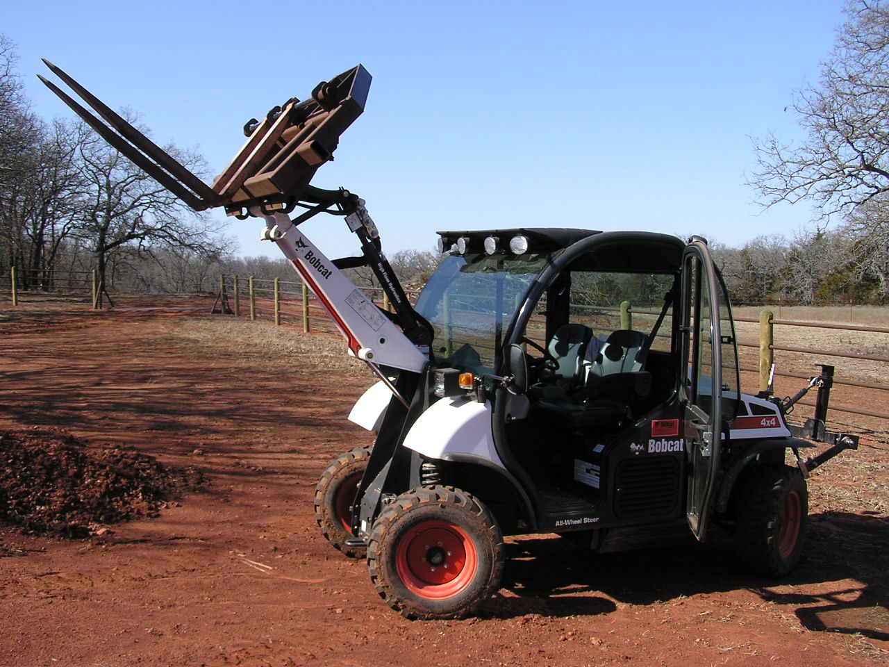

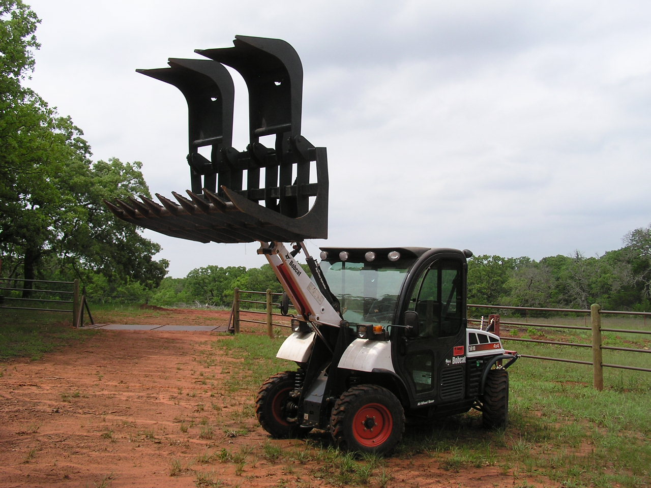

Have not used the hydraulic PTO, only rated at 25hp, But Bobcat is very conservative with their ratings.
One possible disadvantage is the 7' lift height of the loader boom.

If I read your post correctly then you will be looking at mowing grass that is upwards of 2 feet tall. Don't think you will be happy with the finish mower. It will not cut that well and without high flow will bog down and quickly overheat. A brush cat will do a much better job. I have some steep hills on my place and am happy with my 5600 model A. It truly is a work horse for me.

Don't give up on the front 90" mower, the only negative comments are from older series 5600 owners.

Good luck and keep posting. I planned to get the front mower, if it didn't do good with the brush hog that I already had, but it handles it just fine. When I get the brush under control I plan to get the 90" mower.
