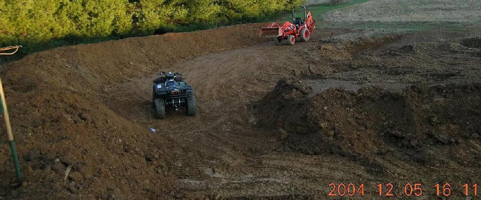

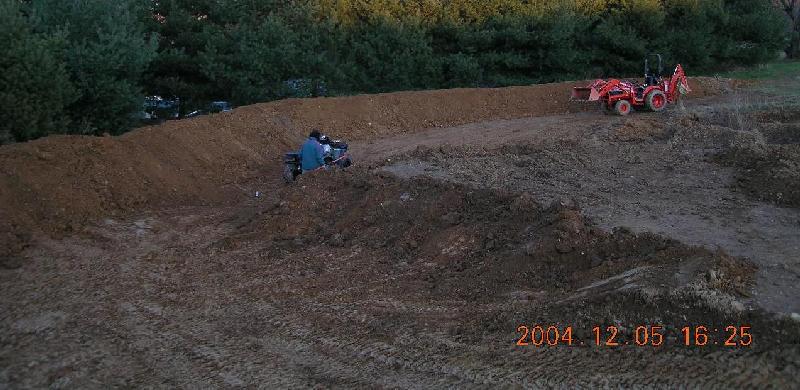

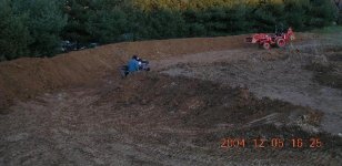

Here's some pics of my pond. As I stated earlier, it's 150x400, and I'm just salvaging the topsoil with my FEL.
Here's a wide shot taken from the deepest corner, about 3 feet right now. The wet spot is the "sump" where all the water collects for "automatic" siphoning into a nearby canal.
http://webpages.charter.net/bobad/pond3.jpg
It's good to have a little help from my son, who is on Christmas break. The dirt piles are bigger than they look!
http://webpages.charter.net/bobad/pond2.jpg
The deep end from inside the pond, showing a ramp. I have ramps in each corner. Digging is not the problem, hauling the dirt 100's of feet is the problem!
http://webpages.charter.net/bobad/pond1.jpg
Merry Christmas to all!

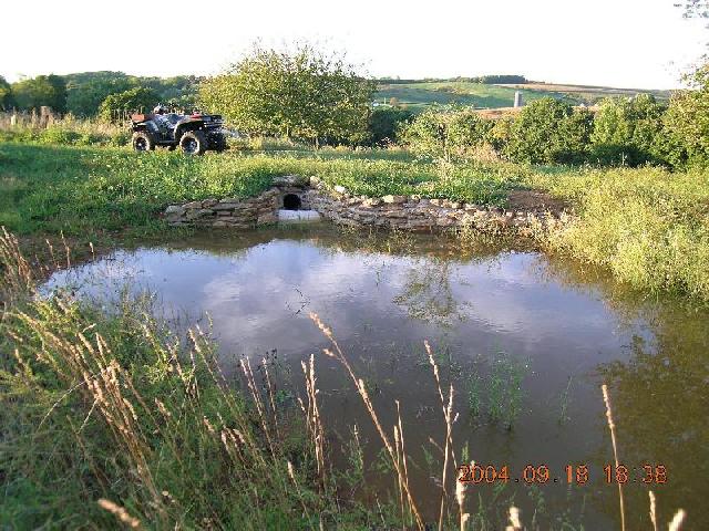

Did you say three "DAYS" to dig out all that dirt? Your website says three "years." My big pond is similar in size and it took me a month to dig mine with my backhoe. Hauling the dirt off took most of the time.

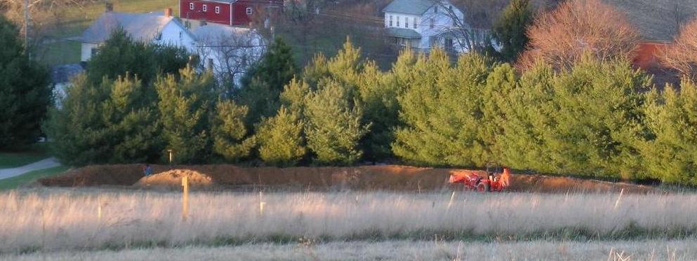

I understand. The digging part is the easy part. Moving all that material is what hurts. Especially when it's wet! You did a great job on the pond and I admire your determination!!!!
Muddy colored water might also be caused by the electrical charge of the water. I forget now if it's positive or negative, but the eclectrical charge will suspend dust particles in your water and it could take years to clear up. The article I read in Pond Boss Magazine said to use "gypsum."
Gypsum is what sheetrock is made of and can be bought in bulk powder form at fertalizer suppliers and some feed stores. They recomended starting out with one ton per surface acre. You must use the powdered stuff, but scrap pieces of sheetrock also work, and mix it into your pond.
Throwing it out the back of an outboard boat with the motor running mixes it all up really good. Or so the article said.
I'm waiting for spring, then I'm going to do it the hard way. Put it on a raft and mix it in while swimming around.
