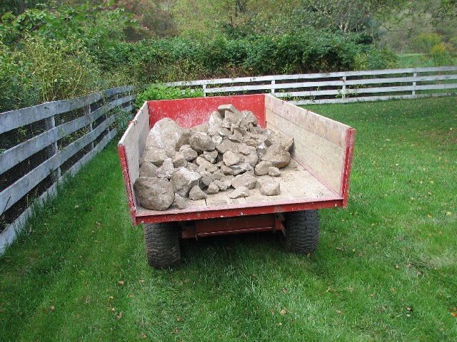

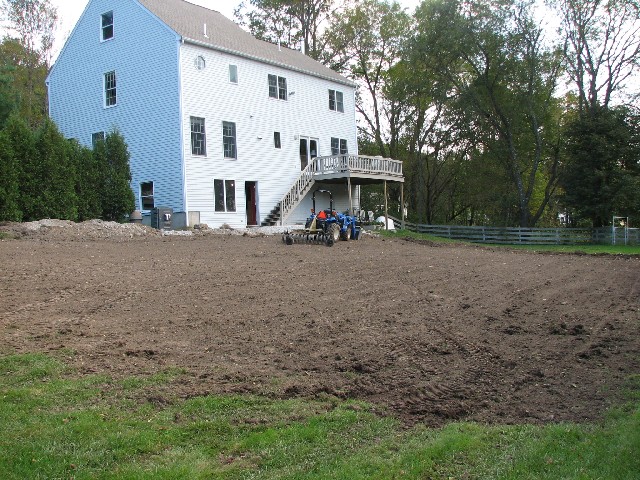

Attached are a couple more pix
After ~3 hours w/ the landscape rake - (first time I used one)
Close up of the abuse we inflicted on the dump trailer

If the yard was flat & the pool wasn't terraced, I'd have buried as much as possible (would have finished the job with 1/4 the effort as well). I had to remove the material to return the natural slope. I did leave the high side wall, about 3' below grade intact. I broke up the entire floor & buried it near the high side wall. Shouldn't have any drainage problems.
I got it seeded on Saturday, we got some gentle rain yesterday:cool: Just have to put the fence back up (took it down to make room for the hoe) and I'll be done 'till spring.
