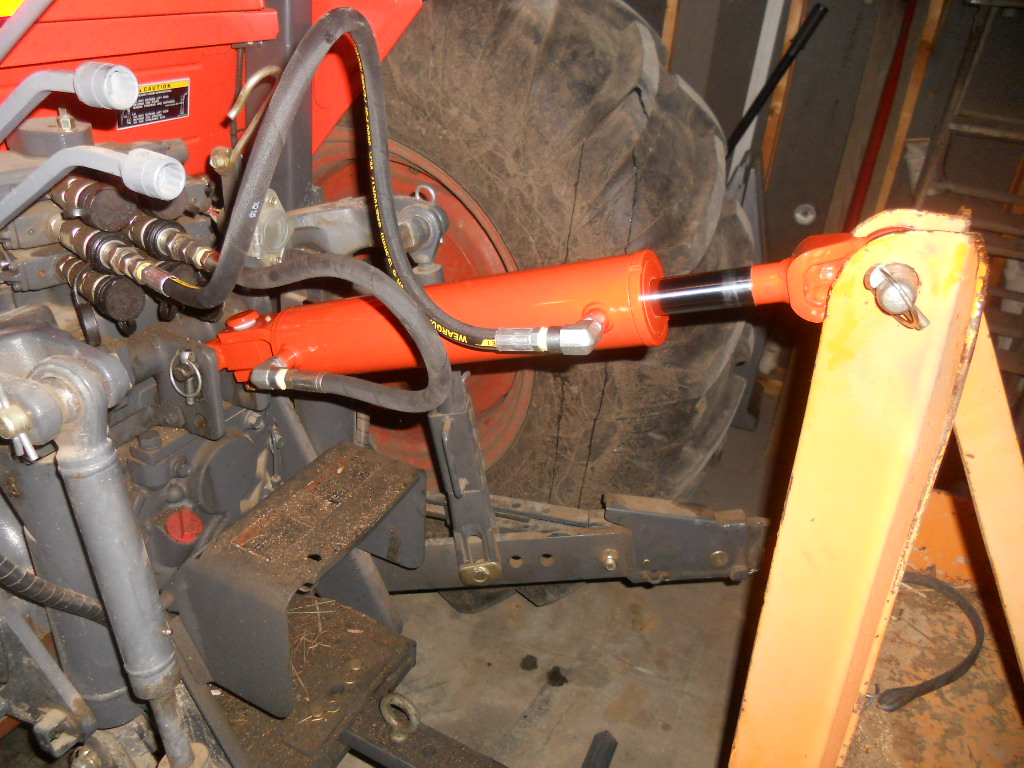

   / Poor man Hydraulic (almost) Top Link - "Hydraulink" #5
Posting Pictures:
Click on "Go Advanced".
Click on the "Blue A" at the far left end of the top icon bar above.
PLACE YOUR CURSOR WHERE YOU WANT THE PIC TO APPEAR.
Click on the square picture with black dots in the corners, second row of icons above, sixth from the right. If you put your pointer on that icon it will say "Insert Image".
Follow the directions. You have a choice of using "computer" or "Url". I use computer. Don't forget to click on "upload file" after you have selected your pic.
Double left click on the picture. A menu box will appear on the screen. Choose a size. I use "full size".
The pic should now appear in whatever size you have selected.
Click "submit reply".
You'll have a pic such as this one.
Nice picture!
Perhaps I will give it a try with my newly refurbished 1920, or my also newly refurbished 3400TLB.
Thank you for the information on how to do it!

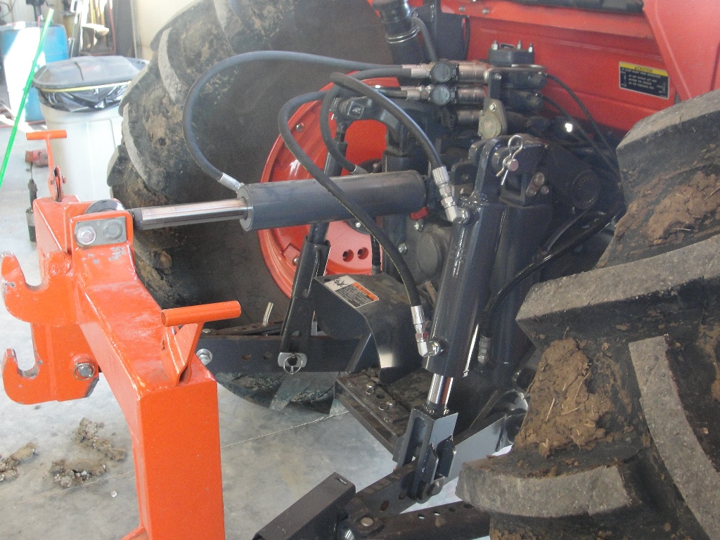

I think the Hydraulink is fine when you consider it to be a new/different type of *manually* adjustable top-link, but that's not even close to the utility/capability of a true hydraulic top link. On many large tractors, you can't reach the top link whether it's screw type or Hydraulink, so it's not going to help a bit there. That was the main reason I wanted/needed a hydraulic top link on my second tractor.
The real cost in having a hydraulic top link is usually the hydraulic valves and plumbing. But if you already have that stuff, you can put together a hydraulic top link on a budget. I paid $200 for my hydraulic top link and another $50 for custom hoses.
