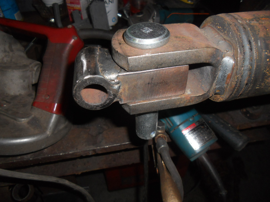

I really like your "double swivel" ends on your top link. Did you buy that or build it??
   / Poor man Hydraulic (almost) Top Link - "Hydraulink" #12
You know I'm cheap right?:laughing:
I wanted a "just right" stroke so I built it. I'll practice my big pic lesson.

I do believe that I can easily reach the "Hydraulink" adjusting valve without getting off my tractor.
75% of the time, not 100% of the time.
Sometimes you cannot reach the valve, which often orients itself down, which is a weakness in the design.
Sometimes load on the HydrauLink is such that you have to get off the tractor to put enough hand torque on the (downward oriented) valve to move it. Hand torque has always been enough on my Cat I HydrauLink. I have NEVER required a wrench.
Is the LOA for a Cat II HydrauLink the same as the LOA for a Cat I HydrauLink? It the Cat II HydrauLink is longer than the Cat I, you will not be able to use it with some of your Cat I implements.

Very nice work Eric!! Professional design and welds!!

The CAT ll Hydraulink LOA is greater than the CAT l, but I think that is an ADVANTAGE with my Pat's Easy Change.
I do not think the CAT l would be long enough with the Pat's, which lengthens the lift arms by about 4".
