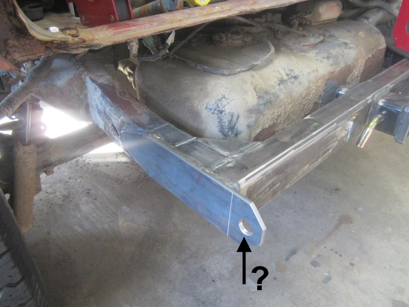

Just curious about the holes?
/ Poor man's side by side
#105
Shackle tabs...or D rings, whatever you prefer. When offroading sometimes it's handy to have a choice of tow points. One good example is poping someone out of a snowy ditch. Ditch side on stuck rig, and opposite side on tow rig. Opposite keeps them both going in a straight line...or can pull the tow rig in the ditch too.
I didn't have anything capable of drilling for a 3/4" shackle so I'll pick up some 5/8"ers. The Tracker's half the weight of the jeep, so should be plenty strong.

Finished the rear frame section

Shackles (used them alot today) and licence plate
