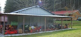

One final shot of the house three years later with a slight wood grain tint I put on the last year. Still holiding up strong.
Ignore the toys (uh, excuse me, I mean my "essential tools, honey")in the foreground, the house is in the background.

One more comment on the longevity of poplar siding. Here is a shot of the original homesteading cabin on my property built in the late 1860s and occupied until 1969. I still use this building today to store my lumber.
The siding is rock hard poplar, about 3/4" thick.
