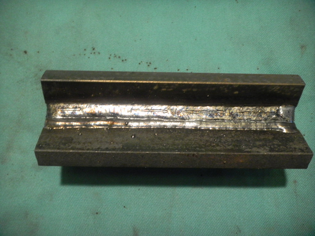

Any of you guys ever run into this problem? Years ago I was welding 24-inch pipe to 2-inch thick plate for a project up in Prudhoe Bay. These were columns for a building. Contractor drilled holes in the ice, placed these pipe in the hole, and filled the hole with water.
For the life of me I could not stop the worm tracking:eek:. Every welder in the crew could do no better. Come to find out when the kid unloaded the pallet of wire from the truck, he dropped the pallet of wire off the forks of the fork lift:eek:. Broke the flux on the wire.
There are other reasons dual shield will worm track, most of the time the wire has picked up moisture, and needs to be dried out.

Shield that is pretty weird there. The only thing I could think of there was the metal would not reach temperature for welding because of the cold weather. I have received bad flux core before in the old days when we all considered flux junk. Flux sure has come a long way in the last 20 years.
Shield, I had this problem several times and it was always due to moisture in the wire. Have you ever successfully dried a spool of wire to where it stopped worming? I tried drying a spool in an oven for an hour at 250* but it didn't help much. Last time I just junked the spool and grabbed a new one---end of problem.
I've never done it my self. On the job you just grab another spool of wire.
I thought I had a Lincoln procedure for drying dual shield wire book marked, but can't find it right now. :eek:
