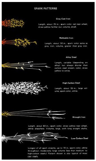

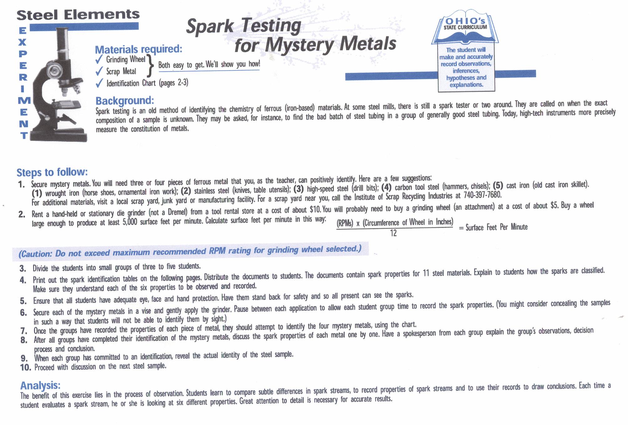

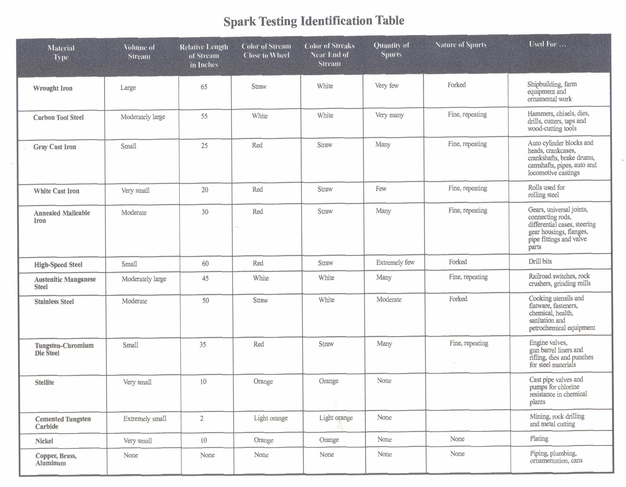

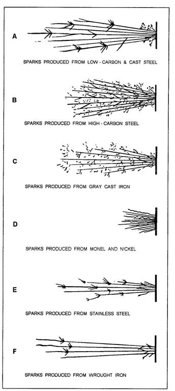

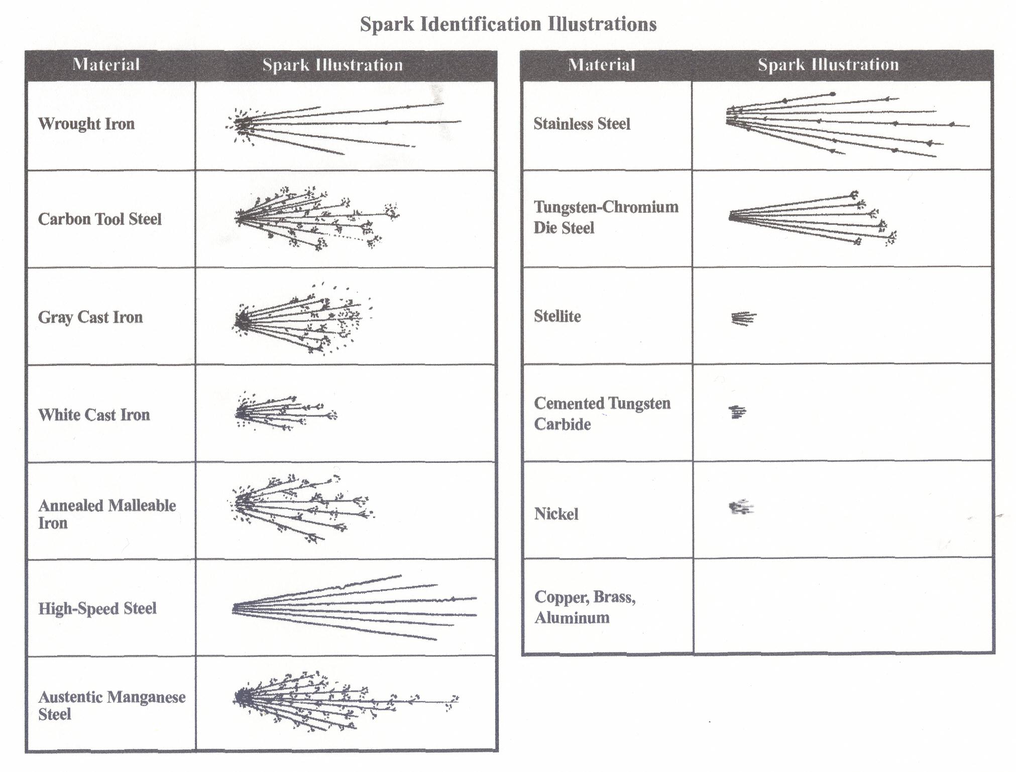

   / Porosity in a weld; what caused it #13
Here are some charts that may help.
Weldermike;
Yes strong magnet attraction with orange sparks. I did this before even grinding to see if it was steel or something else. Thanks for the input!
SA; yes this helps a lot. I will print and laminate some of these and keep them handy.
The coating on the part looked like some grade 1 bolts that you buy at the hardware store which leads me to believe it was zinc coated but may be wrong; wouldn't be the first or last time!
Definitely learned a few things with this repair and seems that maybe I made some educated guesses to make the repair.
