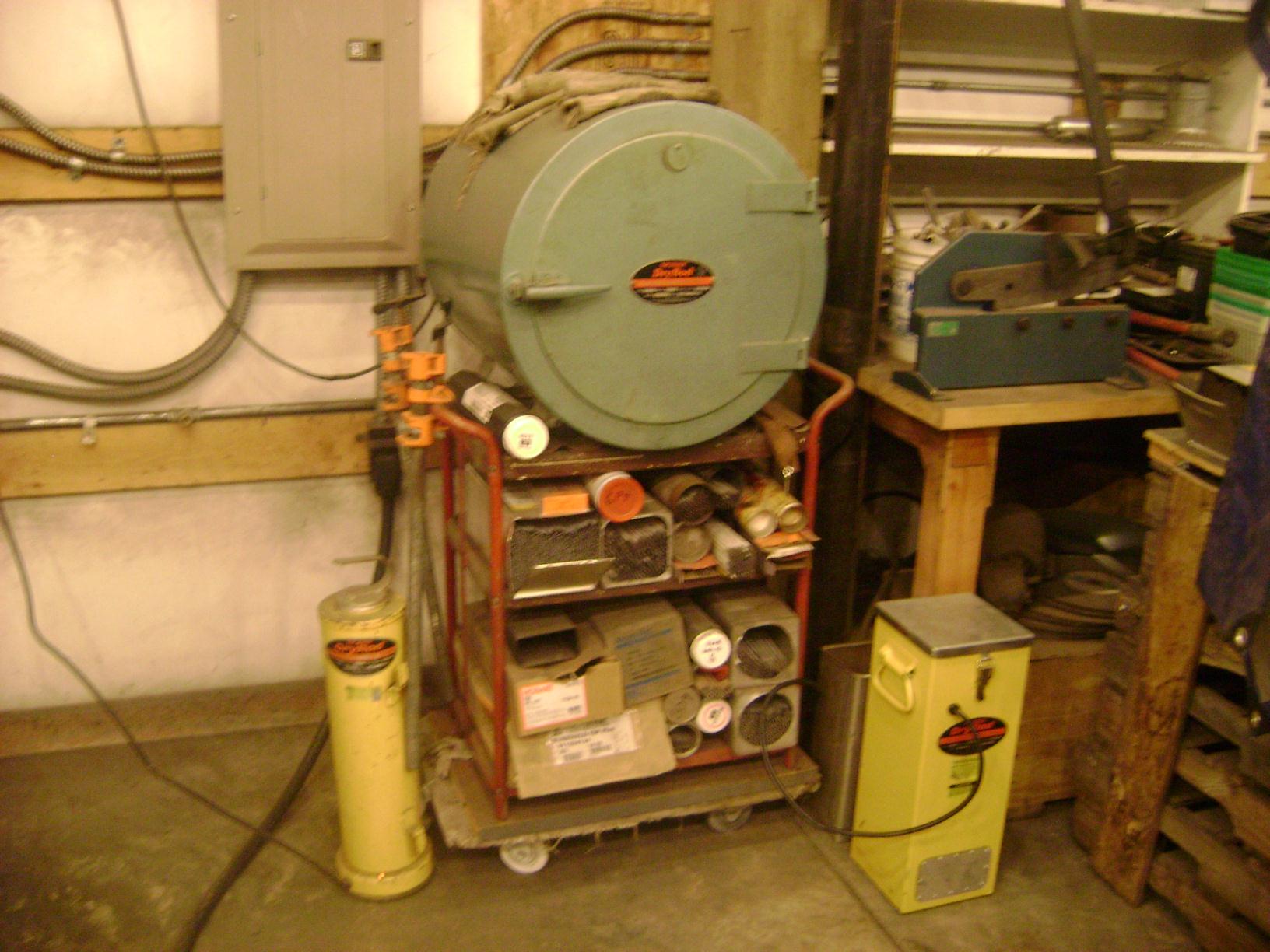

I'm too cheap to pay for a power sucking oven to run 24/7!!
My shop is on a separate power meter from the house. I didn't see any increase in the power bill running my oven 24/7.
If the oven is well insulated there should be little heat loss. So once the oven is up to the set temperature, the thermostat will switch off, untill the temperature drops, and then it switches back on.
If I had a rod oven, I would use a "kill-O-watt" meter to see how much electricity it really uses.

At $2-5 per pound (or more), you don't have to throw away many rods to pay for a rod caddy. You don't necessarily need a #350 oven like I have. Phoenix Dry Rod ovens also come in 10# and 50# sizes to fit most needs. As has been said, once hot the thermostat will cut off and they are pretty well insulated so the heat stays in. I have seen the 10# & 50# ovens sell for less than $100 on Craigslist so not too much money to invest in order to have dry rods and not have to throw any away.
My shop is on a separate meter and unless I run a heater in winter, I don't get past the minimum charge from the electric company.
