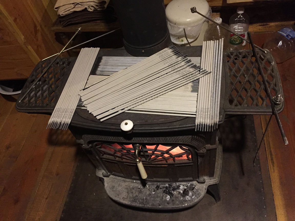

Cooking rods on the woodstove. Will put them in a sealed weldingrod case from Harbor Freight. Hope this ritual is genuinely necessary.
   / porosity - welding mild steel, 7018 rod #37
IF you're RE-drying, I hope your stove gets a bit hotter than mine
Storing and Redrying Electrodes
Note that non-LoHy rods require different handling... Steve
BTW rankrank1, my Phoenix dry-rod portable 20 pounder has a 350 watt element, but typically once it's warm it only runs somewhere around 25% of the time - at my co-op rate of $.08 per Kwh, it costs me about $5 a month. I only use it for 7018, all other rod just gets kept in canisters next to my water heater, never had a problem...
