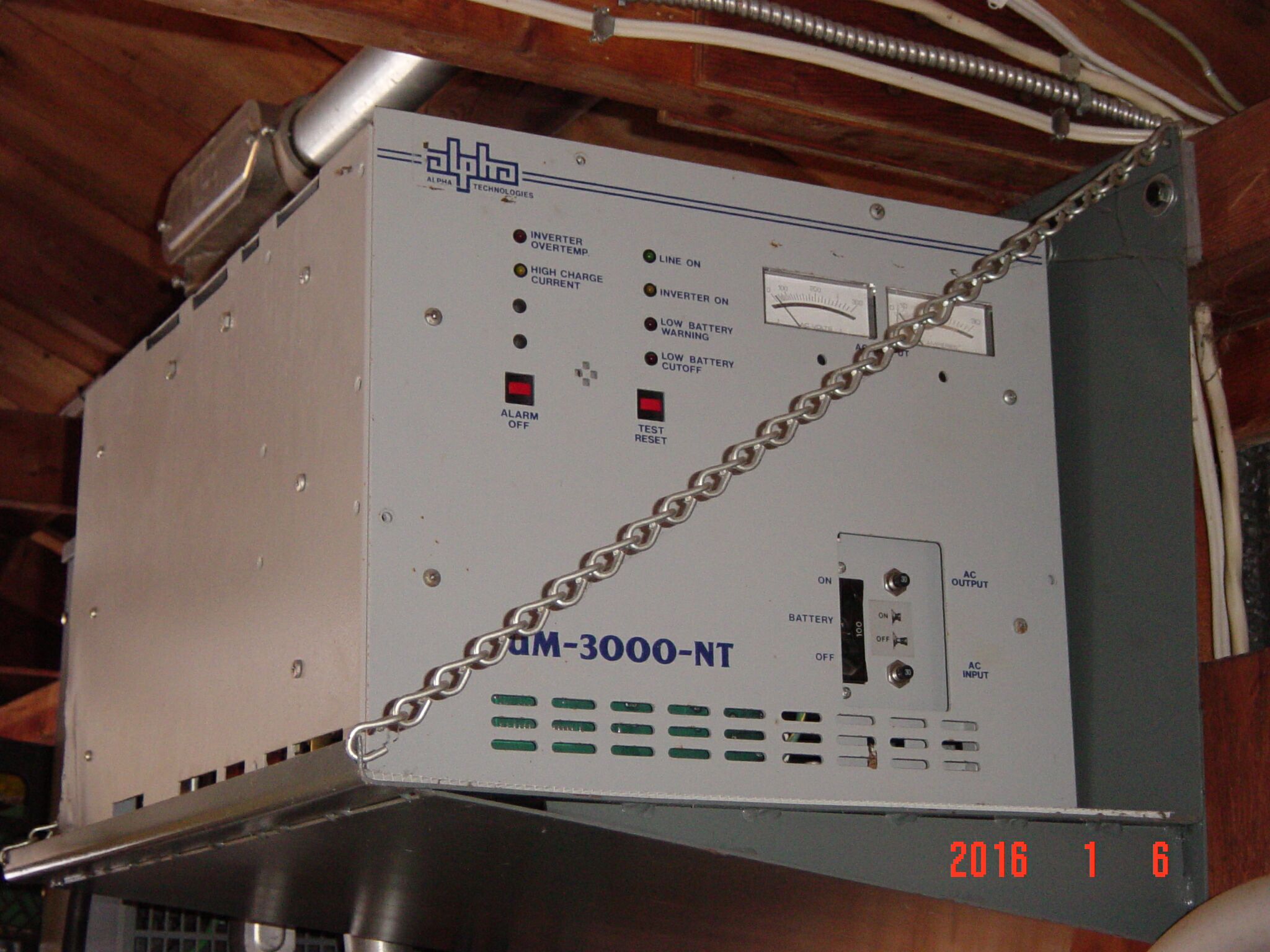

I have a 3000 Watt Telecom Inverter all wired in with a manual transfer switch behind my automatic switch. But the 48 volt battery bank died and I have been "MEANING" to make an Anderson connector off of my 48 volt E-Gator. In the back of my mind, is the thought that by many days end, the Gator is 1/2 discharged. Not a good place to start for back-up. ALSO, I think the Telecom inverter is not very efficient. Idling, it probably uses a good amount of power. I do like it though. It's BIG, Heavy and transformer based, right up my alley! It runs my fridge/freezers all night, and the water pump no problem. ONE major issue. It has never liked the power from a generator as the frequency has to be spot on or it won't accept it. SO I have never been able to charge my battery bank off a generator with this unit. I tried to go in there to defeat the frequncy monitoring but can't get a proper schematic.

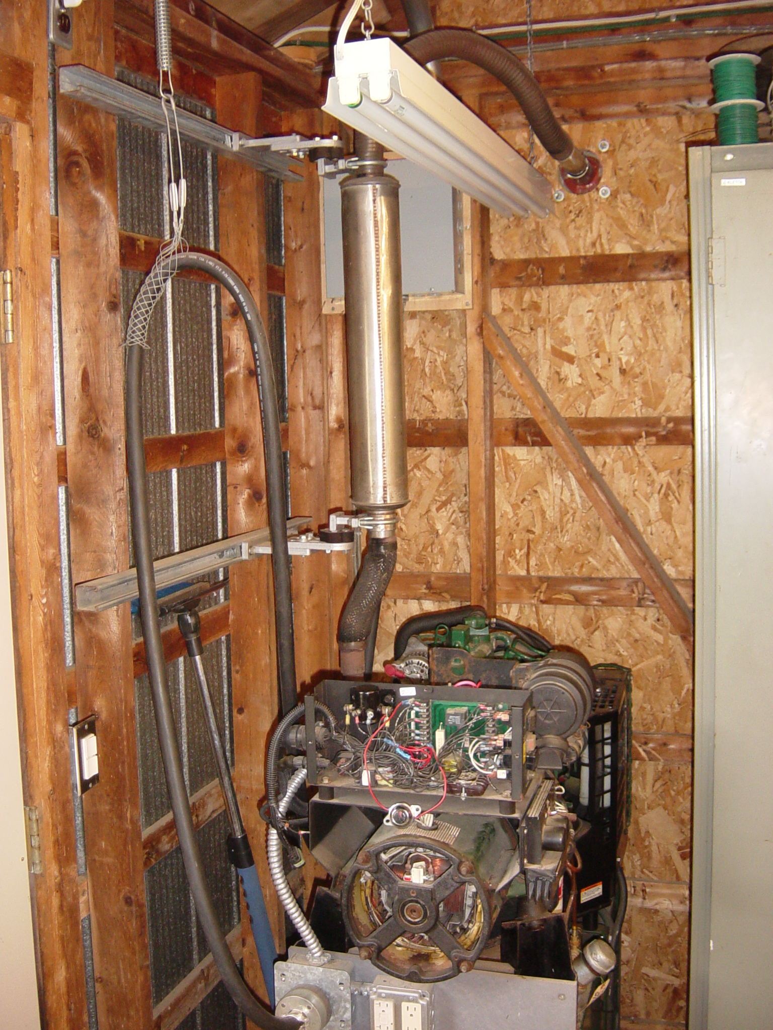

My main genny sits in the corner of my garage/shop. A bit noisy to work in there with it going.
Outside, it's just a gentle purrrr.

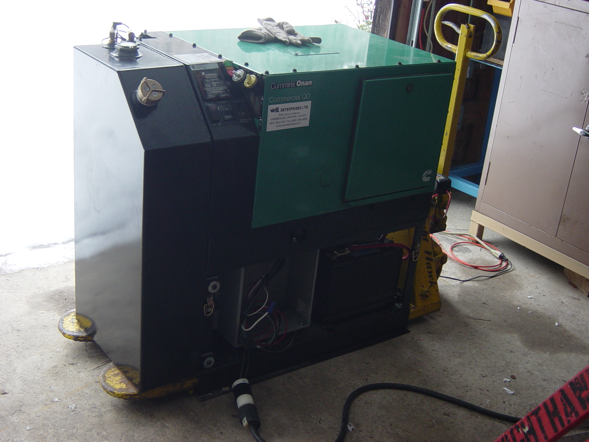

My almost finished Onan 7.5 Inverter Quiet Diesel is so quiet, you can have a quiet conversation at the gnerator!
