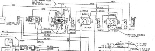

My generator is rated at 30-amps and has a 120/240 L14-20 4-prong locking connector, reading the Owners manual and looking at the wiring schematic it is not clear to me how much amperage each 120v leg will provide. Is each leg rated to 20-amps, 10-amps or is the total combined limited at 20-amps? I understand I can't exceed the generators total amperage rating but want to know what each leg could supply individually. It also has several other outlets but I am just unclear on the 240V outlet. My guess is the breaker will kick if the total load on both legs exceeds 20-amps.

Here is the wiring diagram -
Looking at 240 plug it looks like the two 120v legs (red and black) run thru two 20-amp breakers. Indicating a total plug ouput of 40-amps limited by the generator total output. Your thoughts?

Their’s not enough of the drawing to get a full picture. One plug looked like it had a 20a breaker and the other had a 30a breaker. I couldn’t see where the wires went off the bottom of the drawing.
Having 2 20a breakers feeding a 240v circuit makes a 20a 240v circuit. Not a 40a circuit. USA 240v is split phase- each phase has 20a on it. Adding the two phases increases the voltage- not the amps.

Thanks, I believe my questions have been answered. Each leg is protected by a 20-amp breaker, if total amp output of the generator was 40-amps I could provide a service panel with up to 20-amps at 240V or by splitting the 120V legs up 40-amps at 120V. Correct.

You have 3 circuit breakers, according to the schematic. One 20 amp/120 volt single pole feeding a GFI receptacle which has a normal 120 volt receptacle downstream from it which is also ground fault protected, a 30 amp/120 volt single pole feeding a 30 amp/120 volt receptacle (generally used on shore power for a boat or to feed an RV) and a 20 amp/240 volt receptacle which you should use to plug in a cord to your emergency panel through a 20 amp 4 wire twist lock inlet adapter. Just make sure you have a breaker interlock or a double throw switch to make certain the generator power can't feed the panel at the same time as the normal power. I'm guessing your generator is rated for 4500 to 5000 watts, perhaps a 1000 watts more of surge power.

actually it appears he has a 120/240 switch, which with the crap drawing appears to give him 30 amp at 120 or 15 amp at 240, prolly flips the windings like my old 3k generator

You may be surprised :) but I actually have many years of electronic training and experience, however most of that was solid state, telecommunications and computer logic. As a result I am often confused by the terms and codes used in the residential electrical world, which is why I ask and why I appreciate your feedback. The wiring diagram is very small and hard to read but it does show the L14 plug 120V legs get power thru two 20-amp breakers. I don't need 240V during a power outage and don't want to have to move breakers around in the panel so I was looking at back feeding my panel via an outside 240v AC connect which I believe will provide 120V to all my breakers in my panel, clearly only a few of them could be on. I would turn off the main line breakers going into the panel and remove the line service disconnect to insure I do not hurt any Glen Campbell's of my county.
