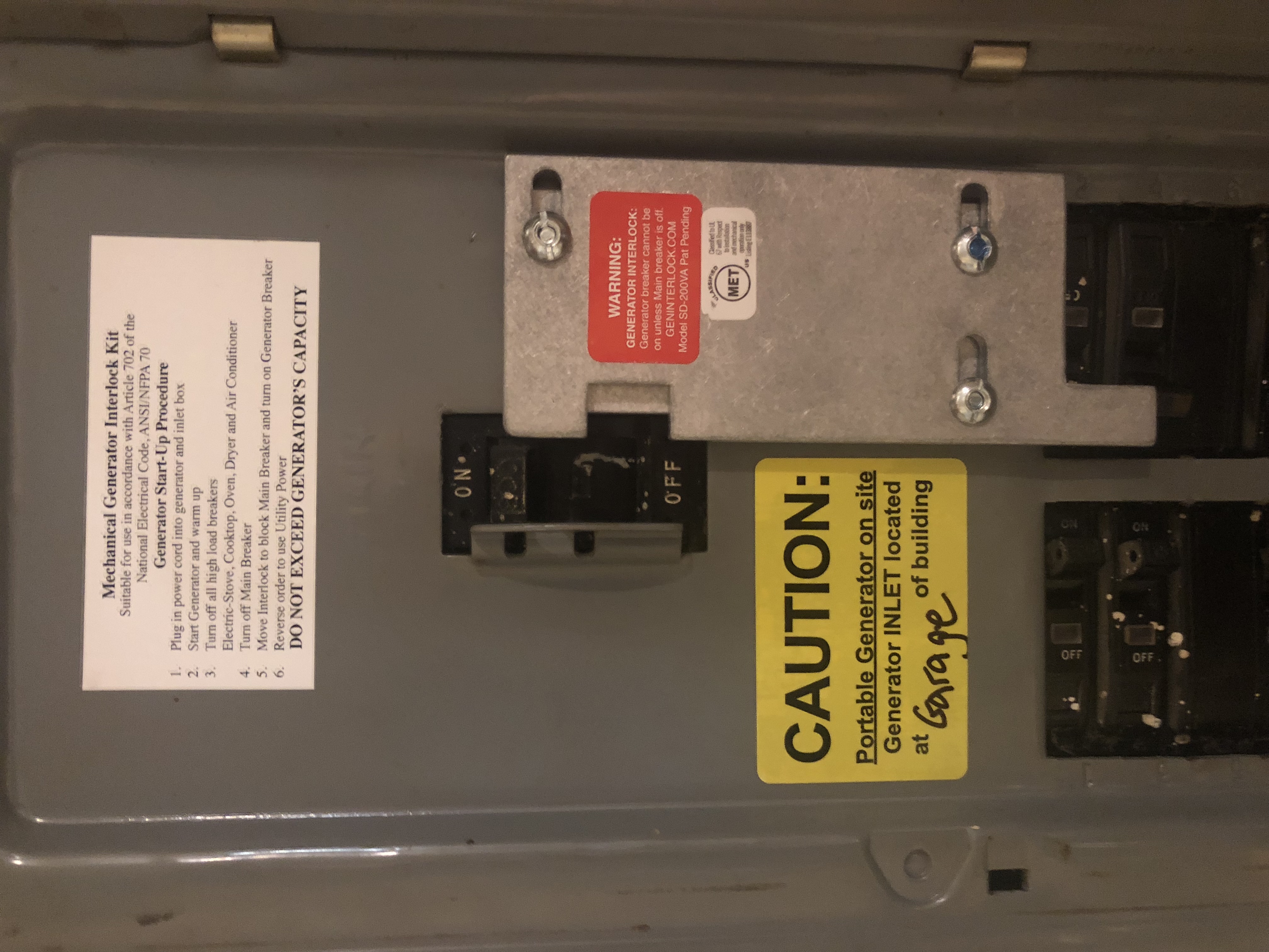

Really excited to finally get everything set up. Figured I would share my setup with everyone. Using a portable generator to back feed panel. Safety panel interlocks in place!
Total cost right at $2,570
I often loose power due to living so far out in the country. Until now I have had to run extension cords through the house and used a 3,050 watt generator to power an AC window unit, WiFi, fridge/ freezer, deep freezer, phone chargers. Real pain to run all the cords and all that.
So to solve all this I purchased a Champion 9,200 watt ( model 100110) generator, 2 Geninterlock.com interlocks ( specific to needs), 2 extension cords,One for 50 amp house feed, one for 30 amp for shop/ apartment over shop.
Generator $1000 Lowe’s
Electrical work $1000
Generator interlocks $69 and $64 plus shipping
50 amp 10’ cord and inlet box $160
Inlet box for shop $43
30 amp 100’ cord for generator to shop/ apartment $180
Power back alarm $45
The generator interlocks are the most important part of the setup IMO. This setup requires a 2 pole 50 amp breaker to be placed in the breaker box. The interlock kit makes it impossible to have both the main breaker and generator breaker on at the same time. It will only allow one or the other at a time. This prevents the generator for back feeding the main power lines or the generator and main line both attempting to power the house at the same time.
I did have to replace my electric water heater with natural gas so that I could free up 2 poles in my breaker box. That was extra cost but not required by most folks.
So, power goes out, I turn on the power back alarm ( notices me when main line is reenergized) and turn off the main breaker and all other breakers off.... go to garage and plug up house side of extension cord and thread the collar onto the inlet box so it can’t be pulled out. Plug the other bed into generator. Next I start generator and go back to breaker box. I double check the main is off, slide the interlock over and turn the generator breaker on. I then turn on all 110 breakers one at a time with a pause between them to allow the generator to recover for items coming on line.
I walked my wife through setup and break down of this tonight. I also printed off instructions.
I will have to add instructions for running the 100’ cord across to the inlet box on shop. It will allow me to power the apartment over the shop for my renter.
The champion 9,200 watt is a beast for less than $1000! I turned on every light in the house, 4 ceiling fans, 1 deep freezer, 1 fridge/ freezer, 1 110 window unit, one large eye on cook top, and 1,000 watt microwave and was only pulling 3 to 5 power bars of the 7 available. I consider this to be a overall great investment. Will make life much easer!
I do plan to get a 30 gallon drum to store fuel in. Every 6 months I will fill my truck up from the drum and refill it with fresh fuel.

Happy to do the write up. I would have done it years ago if I knew it was able to be done safely at this price.... thankfully a neighbor told me he back feeds his home through his stove outlet and I went from there. He didn’t do it as safe with interlocks and such, but I wanted it to be as fail resistant as possible for the safety of linemen, family and property.
It’s nice insurance for sure. In the last couple months with the summer time storms I have been without power 4 times... 2 of them for 20 hours, one for 6 and the 4th time was the day before the electrician finished everything up of course.... that was a 10 hour outage.

I read the reviews and it seemed that most were from improper install. Even my electricians helper didn’t install it correctly in the beginning. I had to go in behind him and wrap the “antenna” much tighter. But, I think once installed correctly as mine is, it should be good to go. Easy install and removal if I do have a problem.
