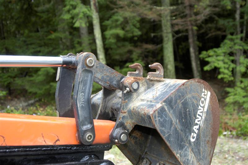

Here3 are a couple of pics of my setup. I have a fewyears on it now and have no regrets.

Casco- Don't you find that center hook in the way when carrying furniture or items like a fridge/stove, large box of whatever? Looks like a great set-up otherwise....

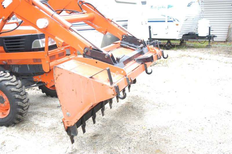

Thanks to research on TBN, when I bought my tractor I bought the ATI quick change setup and a set of forks ($700). The forks make moving large items a lot easier than the bucket
