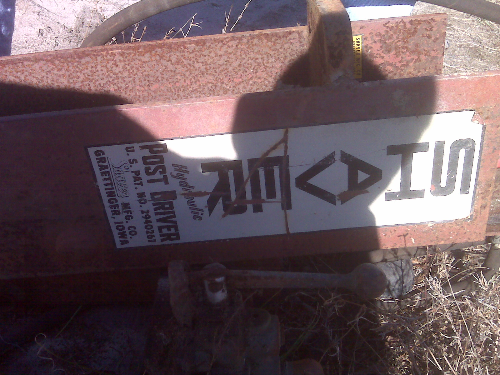

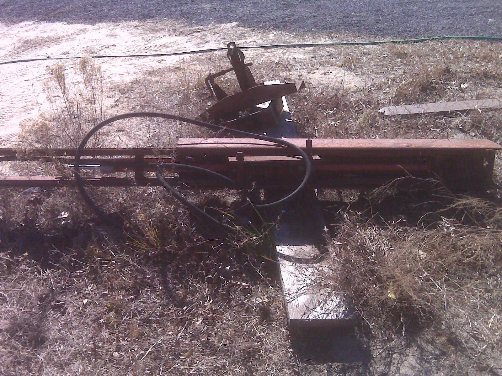

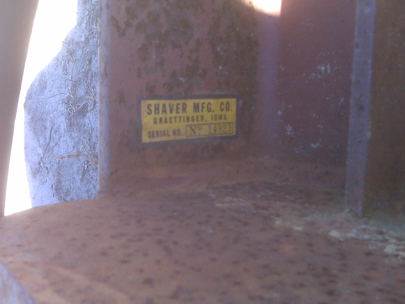

Ran across this locally today. It is for sale for 700.00. It is a front mount and will not match up with my JD 4300. Was thinking of building a 3pt hitch bracket but not sure if it would be worth the work. Anyone can weigh in.

Have you checked with the manufacturer for the availbility of a 3pt mount kit? Might be cheaper than fabbing your own.
Does your tractor have the gpm required to run it? Is it open center or closed hydraulics? Can it be changed if it needs to for your tractor?
That looks to be a shaver HD8, like mine. The price may be a little high if the hydraulic valve and cylinder need work or replacing. A brand new HD8 is $1495 plus $342 for the 3pt mount kit. You might find one for less somewhere else not sure. I have both the new parts manual and new Owner's Manual in pdf. PM me if you want a copy.
My neighbor has the same driver mounted on the front of his tractor and prefers it there. I have mine on the 3pt.

Luremaker, thanks for the info. I have been researching these for a bit and was aware of the HD8. This is much older than that but was rebuilt about two years ago (owner said it cost 1200 for the rebuild).
