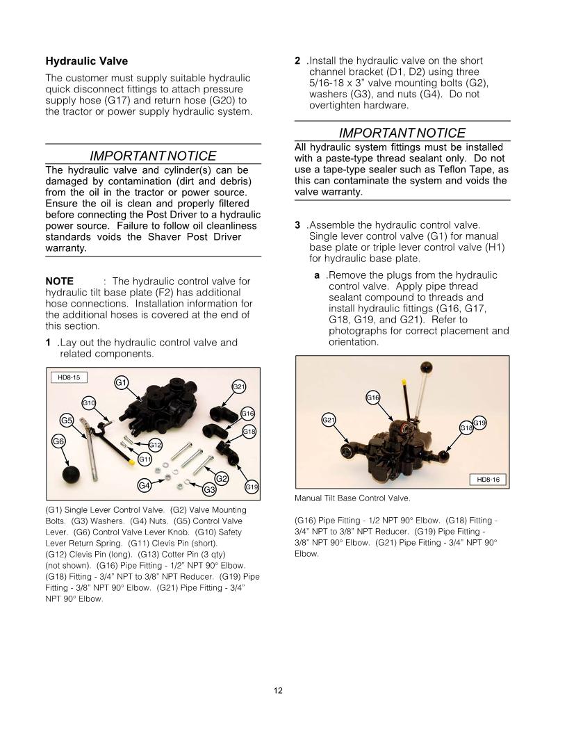

If the driver came off a John Deere tractor, The valve will not work on any other brand without modification or changing. It will work again on John Deere. (open and closed hydraulics) Ken Sweet
Ken, are you talking about the valve on the driver or the valve on the tractor?
   / Post Driver #14
Valve on the driver. Ken Sweet
Looking in Shaver's manual I see no mention of a specific JD valve. Is this still the case or only on early models. My driver was built in the seventies and has the original valve. I though the original owner of my driver had a JD. All had to do was change the quick connects.
