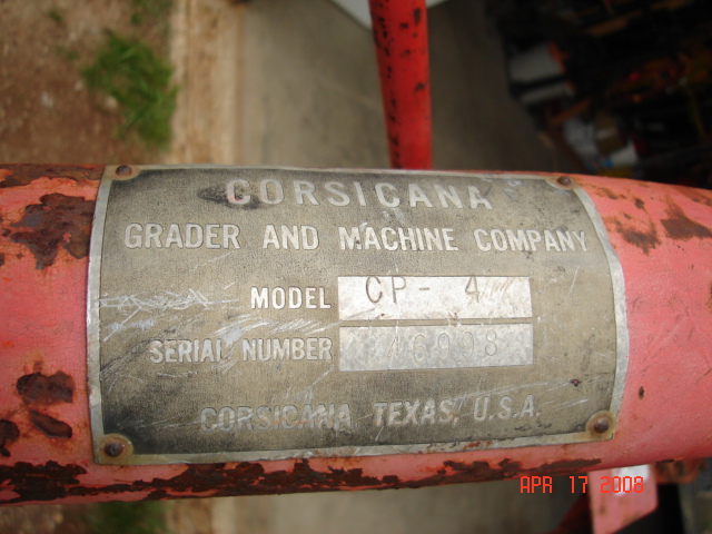

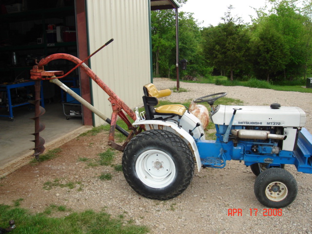

/ Post Hole Auger #17
Mundy said:
My Satoh Beaver is not Grey Market. The PTO spins CCW. I do not know if the B6000 was Grey or not but these first SCUT tractors had many Implements for the CCW PTO. I have a finish mower, my neighbor has a tiller and I have heard of snow blowers made for this CCW PTO. I do not think any Implements are made today for CCW PTO with exception of maybe the PHD shown in the earlier post.
How does that Kubota handle that auger? I have wanted to try an auger on my Satoh but wondered if it had enough power.
I should hope so, I just picked this one up last week, it is a Corsicana which have not been in business for I don't know how long.
I put it on my 15hp Mitsubishi and went out and dug two holes, It needs a new paint job.

/ Post Hole Auger #18
Glad to see it works. I figured it would but feel better making a purchase when I know it will work.
Thanks for the pictures.
