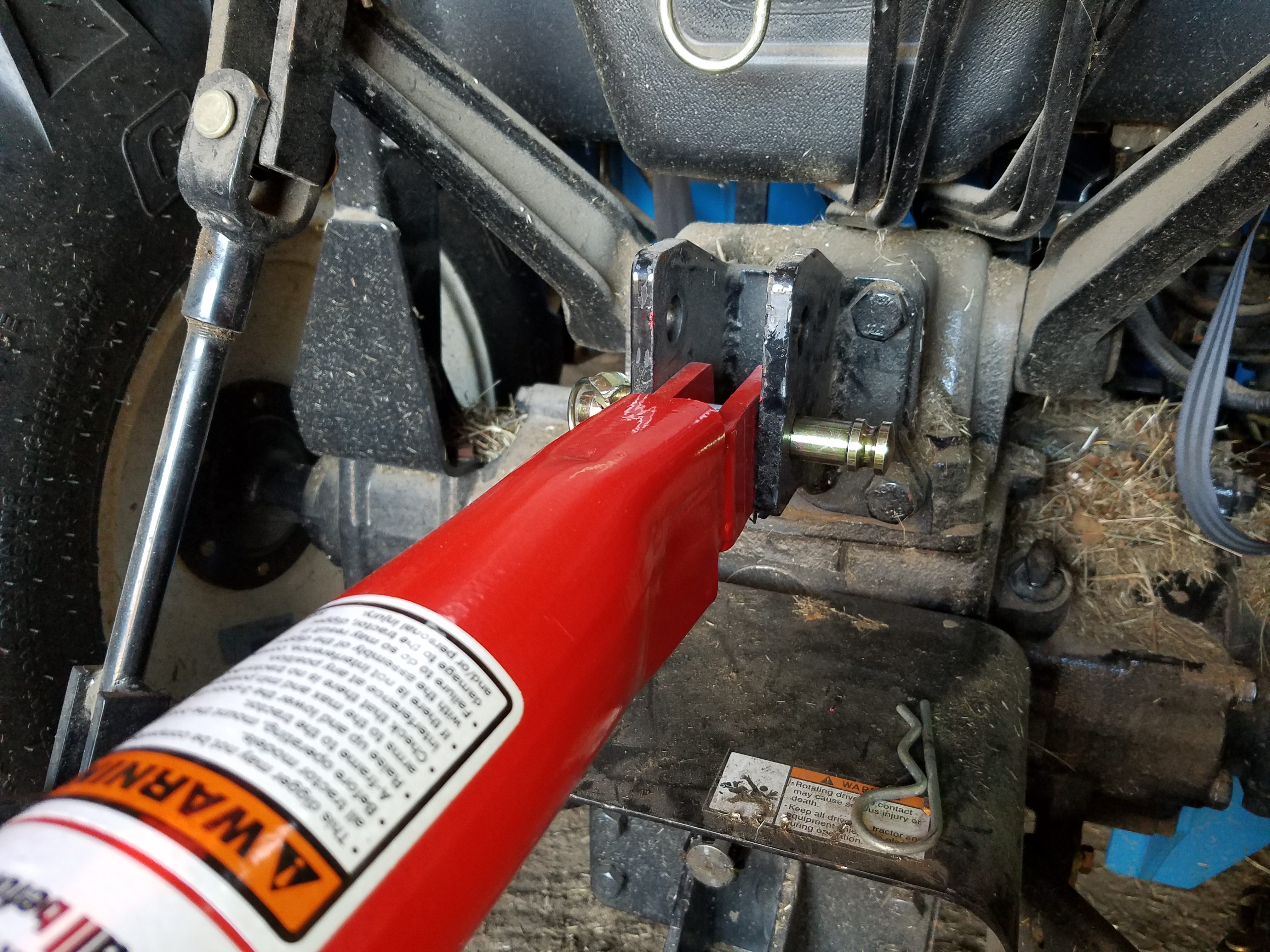

Spoke with Speeco today and they are sending me a new replacement boom via FedEx. The u-bracket on the tractor end of the boom was definitely a manufacturing mistake. Ben at Speeco was great and I was very impressed with his understanding of the issue. I am guessing that I was not the first one to call about this. Kudos to Speeco and thanks to everyone who replied. I really appreciate it!

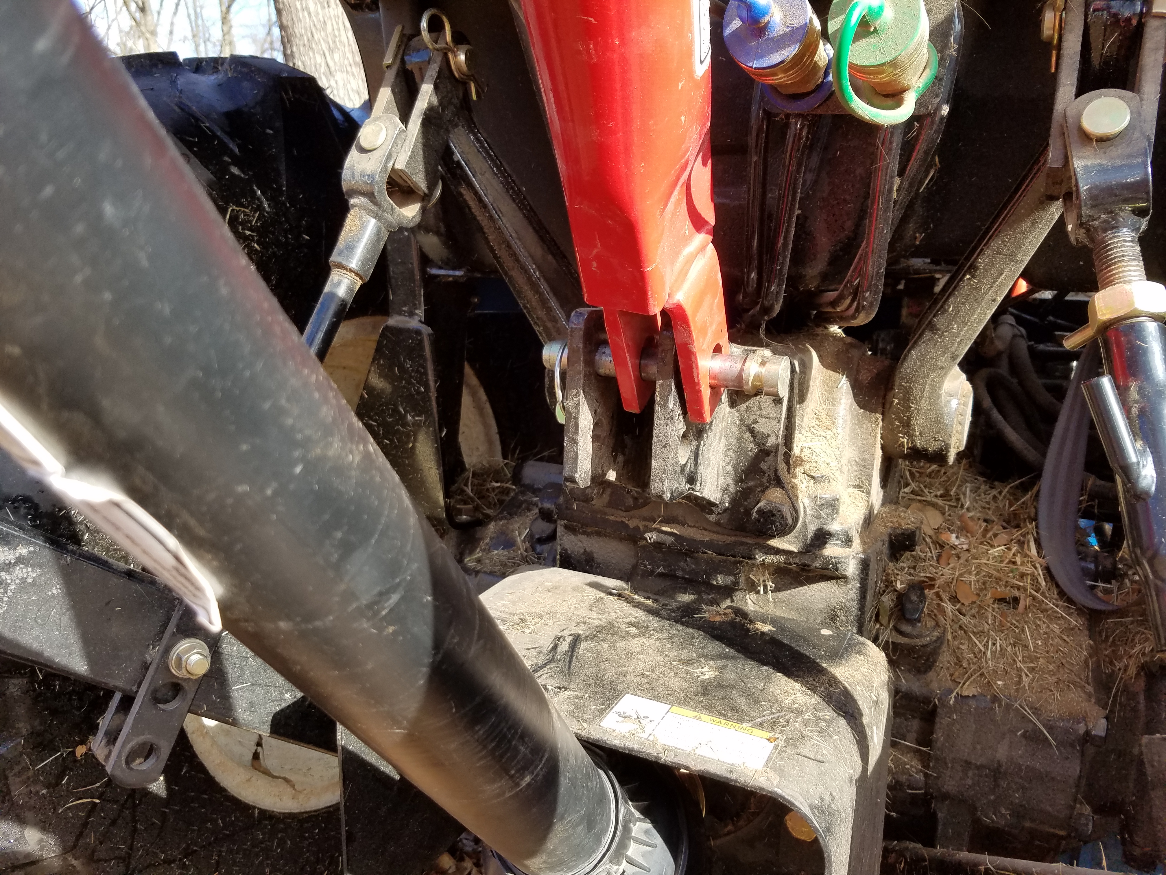

Wow....the replacement boom arrived today (only 3 days from the day I spoke with Speeco) and it looks good. The U-bracket on the tractor end of the boom measures 1 5/8" OD to fit the 1 3/4" ID top link bracket. This will allow 1/16" play between each leg of the boom u-bracket and each side of the top link bracket. Small enough gap to make it fit easily and not so much as to allow any wiggle or side to side movement. Should be very solid. Will hook it up tomorrow and post a couple of pictures.
Really have to praise Speeco.....they took ownership of the problem, fixed it at no cost to me, and got me the replacement a week earlier than promised. That's the kind of service that speaks volumes about how they feel about their customers!

Hooked up the new replacement boom and it fits like a glove!
Before...using the original boom:
After...using the new replacement boom:
